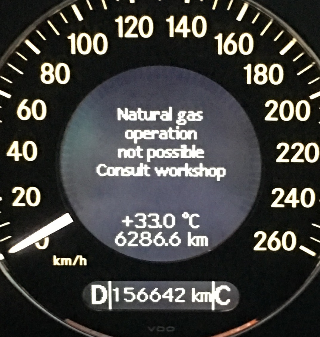

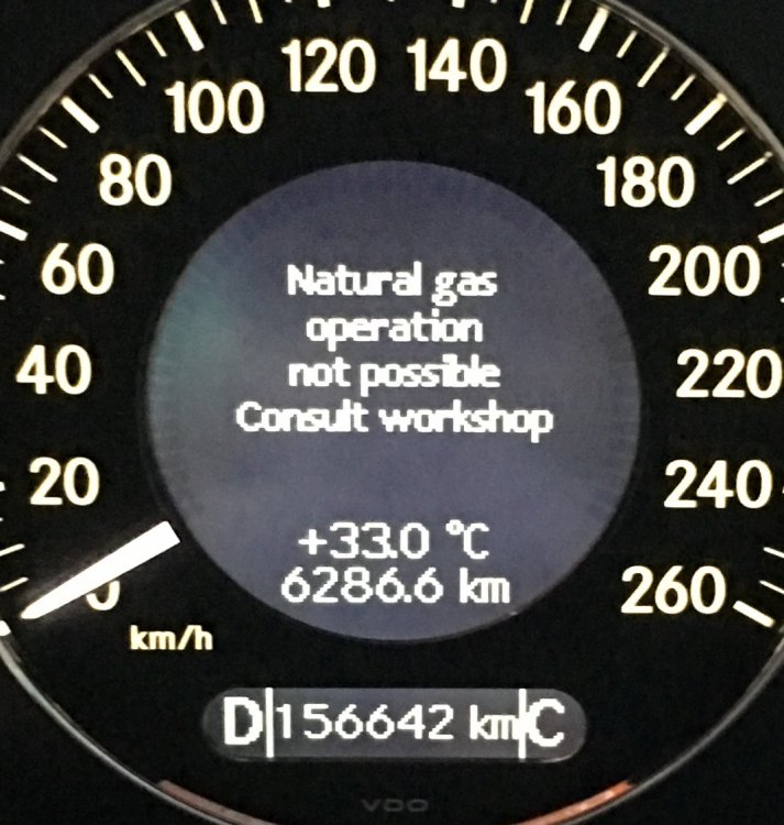

Mine NGT system not working for the last 4-5 years. How ?

Just an update. Had went for the inspection and failed as they cannot test it.
Informed that the system is software disabled and there isnt any CNG gas inside the tank (safe without CNG gas contend, right ?)
They say got to get it working for the test ! Otherwise remove it !
