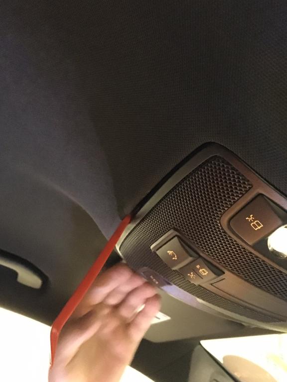

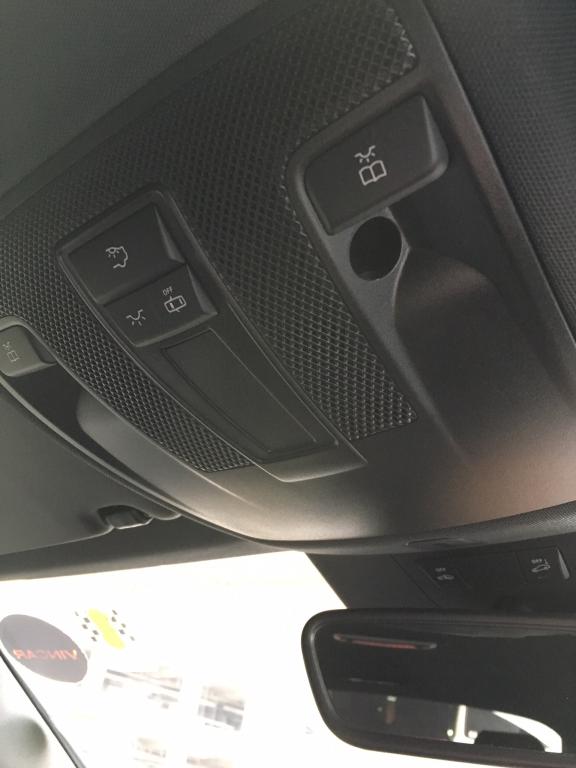

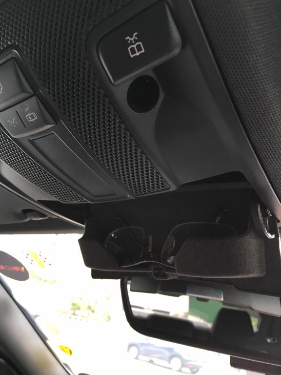

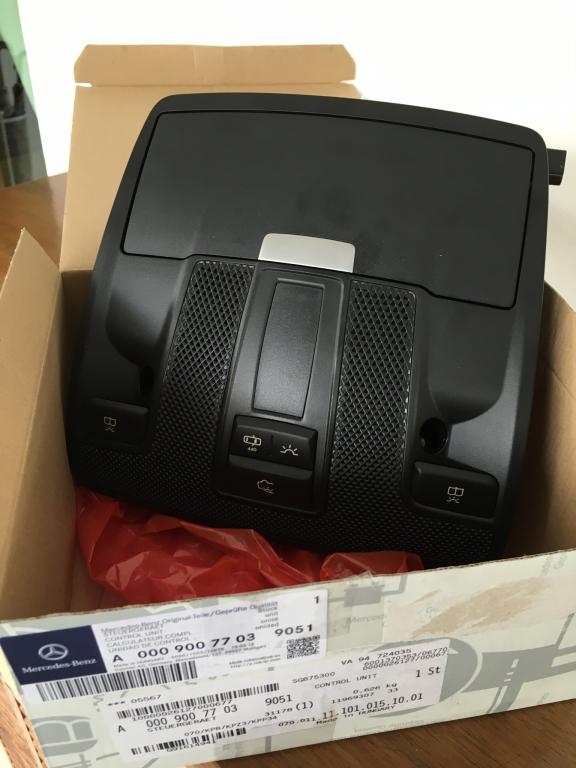

Met a new friend here (Jin) in this forum who's waiting for his new CLA45. He pointed out this sunglasses holder in USA Merc forum. Decided to embark on this project with the part no & ordered thru Goldenlink. Took less than a week to deliver. Cost only $270 before GST.

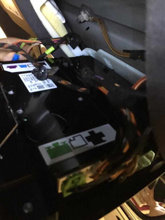

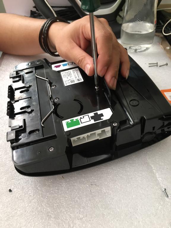

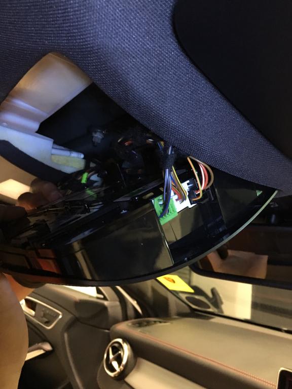

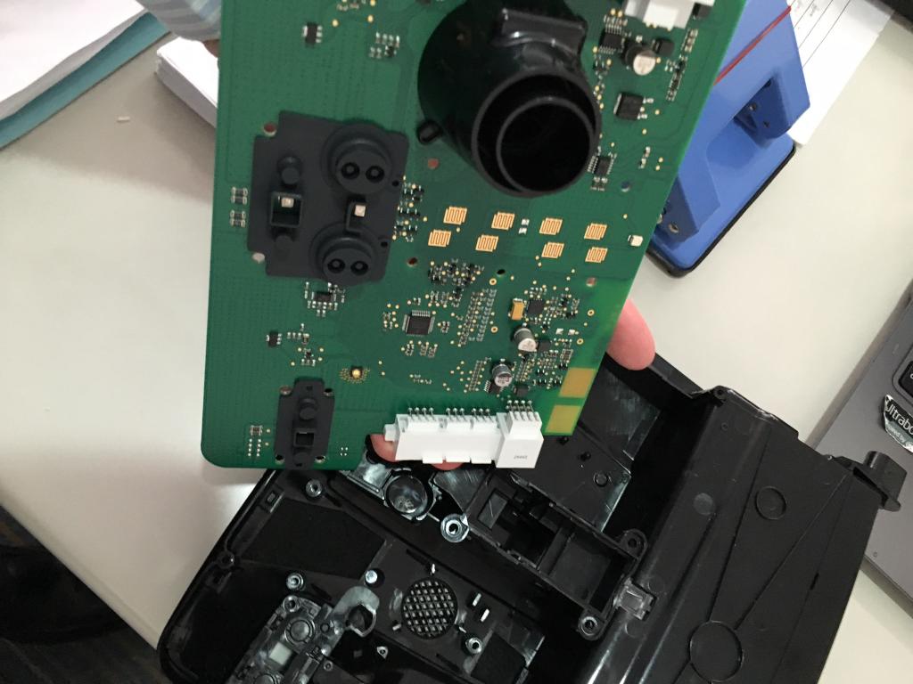

Brought the car to Elebest who took some time to fix it as my car came with A/C climate dual zone control. It has 2 sensors in the console. Had to literally transfer the whole circuit board from old to new. Most of the C&C CLA cars are non climate control A/C....so should be more straight forward.

Please note that for different headliner colours, it is a different model code.
Those with pano roof can also do this mod too, but just need people like Elebest to retrofit the circuit board over.
