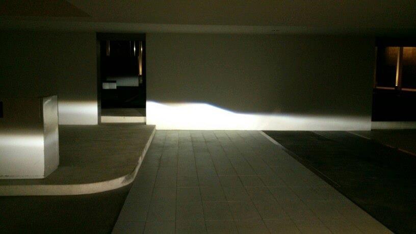

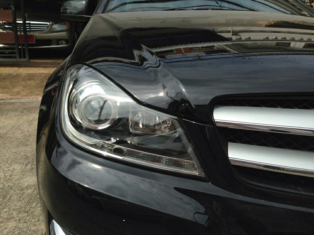

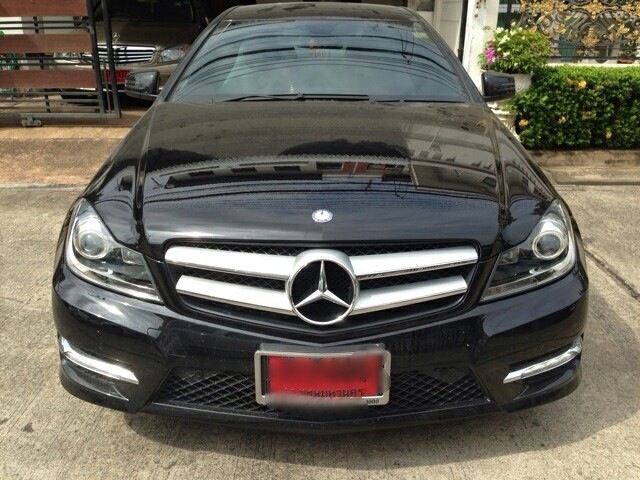

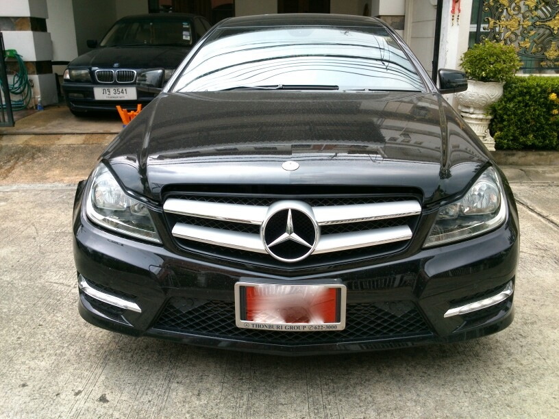

Came across this while surfing the net. Quite interesting for those with halogen headlights. Wonder if any of our sponsors will do this soon! Light beam seems to be properly adjusted for LHD cars.

Light patterns on the wall show that they are LHD headlamps!
Retrofits are very popular back in the states, however some of the newer cars no longer use simple silicone sealant for the headlights and require that an experienced retroffiter cut them open and reseal them after as improper sealing can lead to moisture in the headlights and fog them up. They do make projectors for both LHD and RHD cars so that is not a problem.
