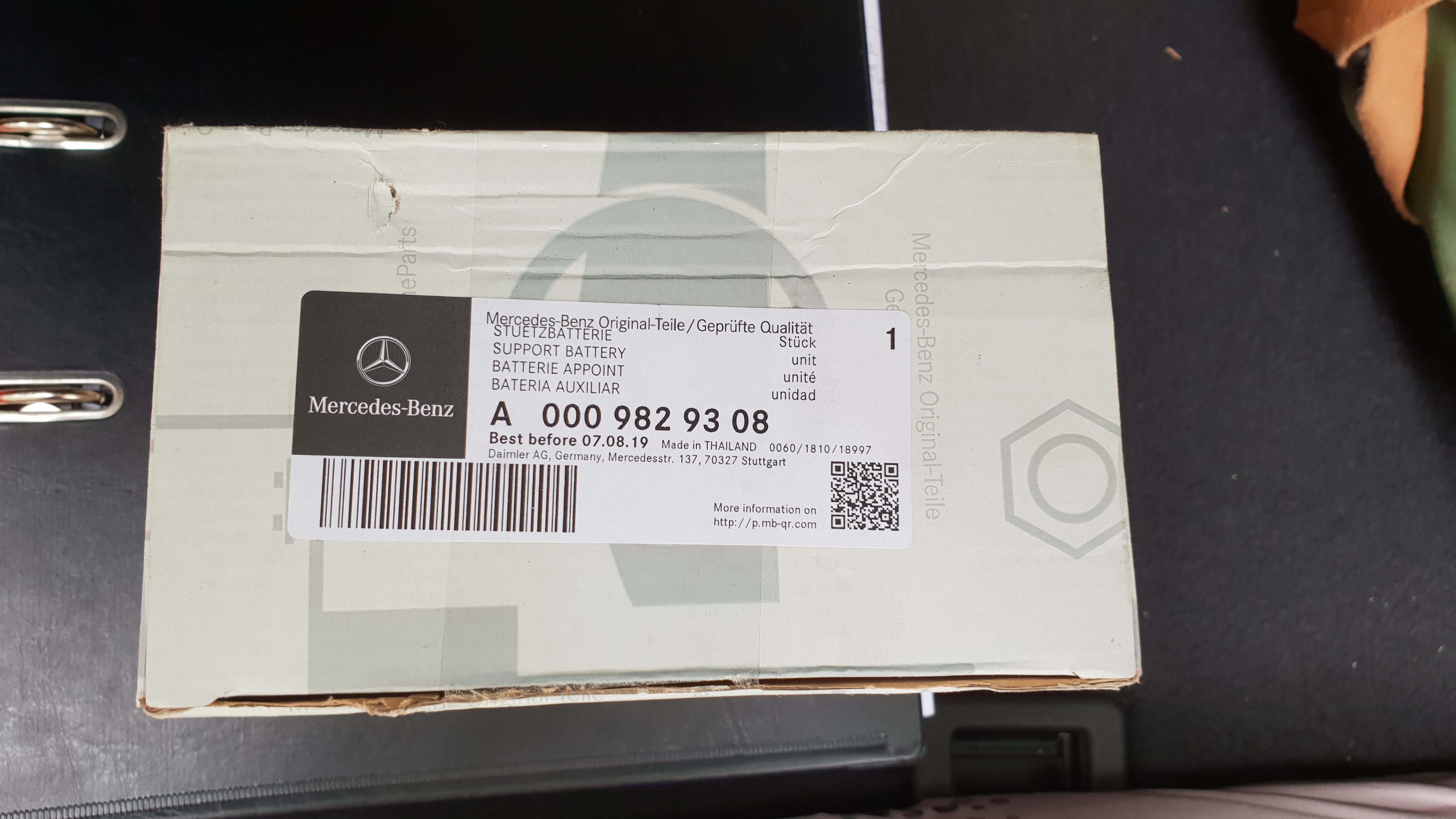

Had this malfunction couple days back on my Dec 2014 W212 E200.
Took the old battery out and charged it on an AGM battery for an hour till 100% and installed back, malfunction still pops out. Guess its really dead after 4+years.
Went to goldenlink and bought the original one for $180before GST (No warranty). Installed it myself using a size10 spanner in 10mins.
As a side note: Hurry tyres has the varta version of the same battery for $180. warranty wise,i didnt ask. Should come with installation.
