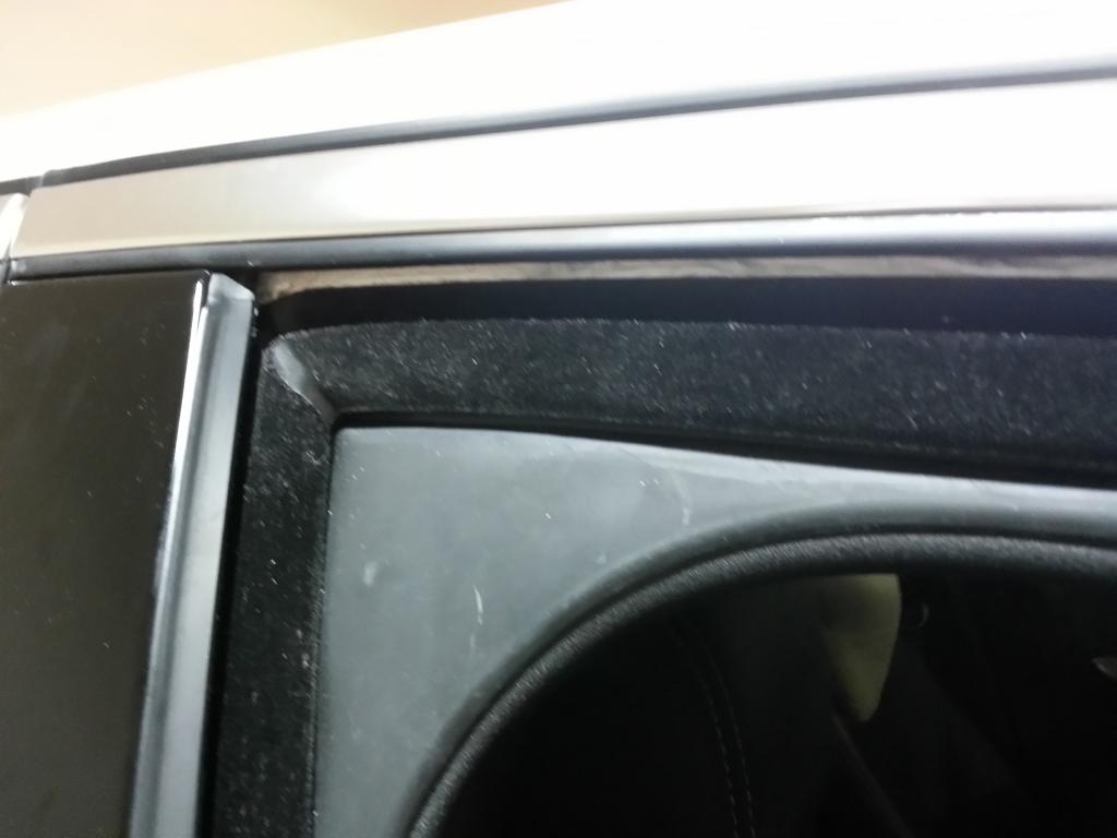

Hi Marcolarco,
Thanks for the sharing and detail explanation. Now I understand that you are referring to the felt seal at the top of the door. I thought it is the felt lining that is between the window and the door instead (please see pic). This is the area where i stuffed the tissue in to reduce the noise. I will try out your method tomorrow and let you know the result. Thanks.
Hi,
I have tried wiping the v shape area behind the felt seal at the top of the door and indeed there were alot of dirt and it did help alot in reducing the noise but not to zero. One thing I have realized is that when i first swiped my finger under a cloth through the v shape area, I could feel that the rubber was quite stiff (could be due to the dirt causing the hardening) but after several wipes, the rubber became softer and felt more elastic. I have done the wiping for all 4 doors and during my test drive, the noise was greatly reduced but I could still vividly hear some tapping sound here and there. Next, I applied some silicon lube spray on all the felt area of the door seal that touches the car body and the windows for all 4 doors and wallah, no more noise. =)
