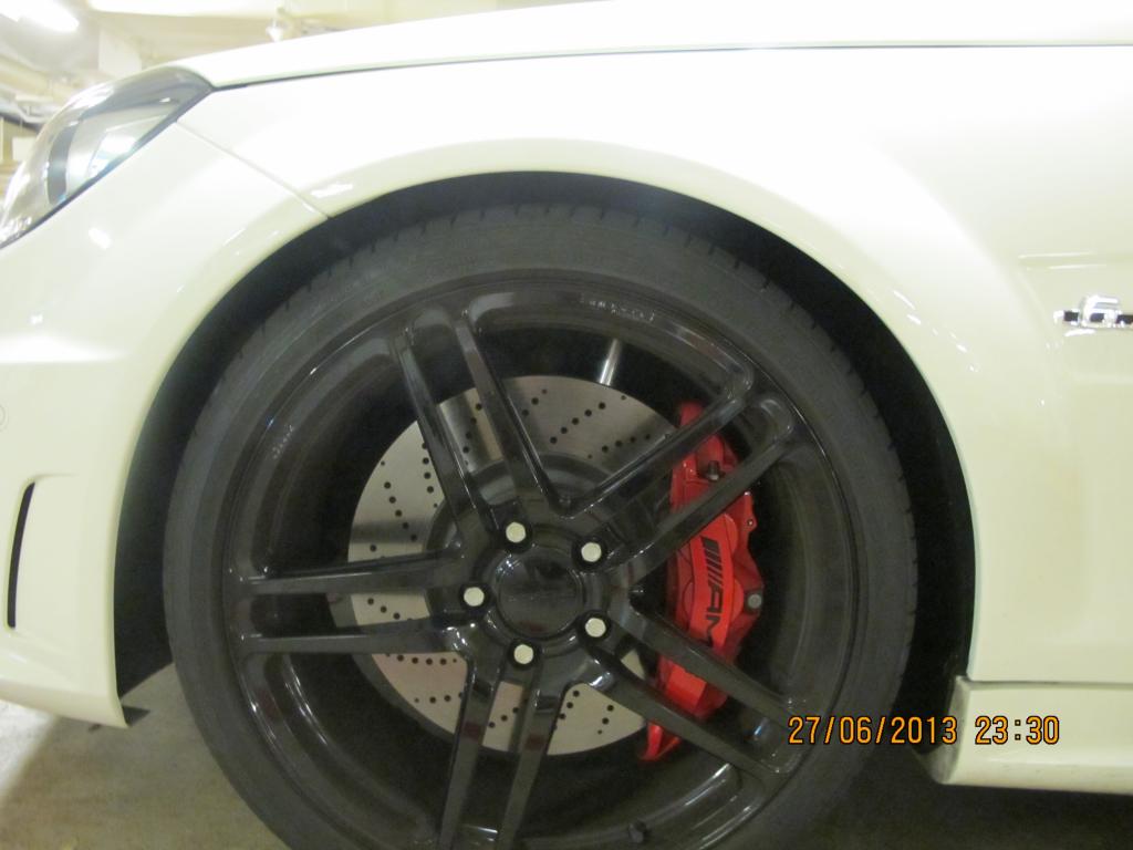

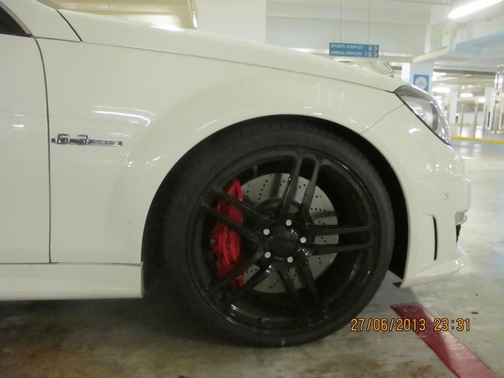

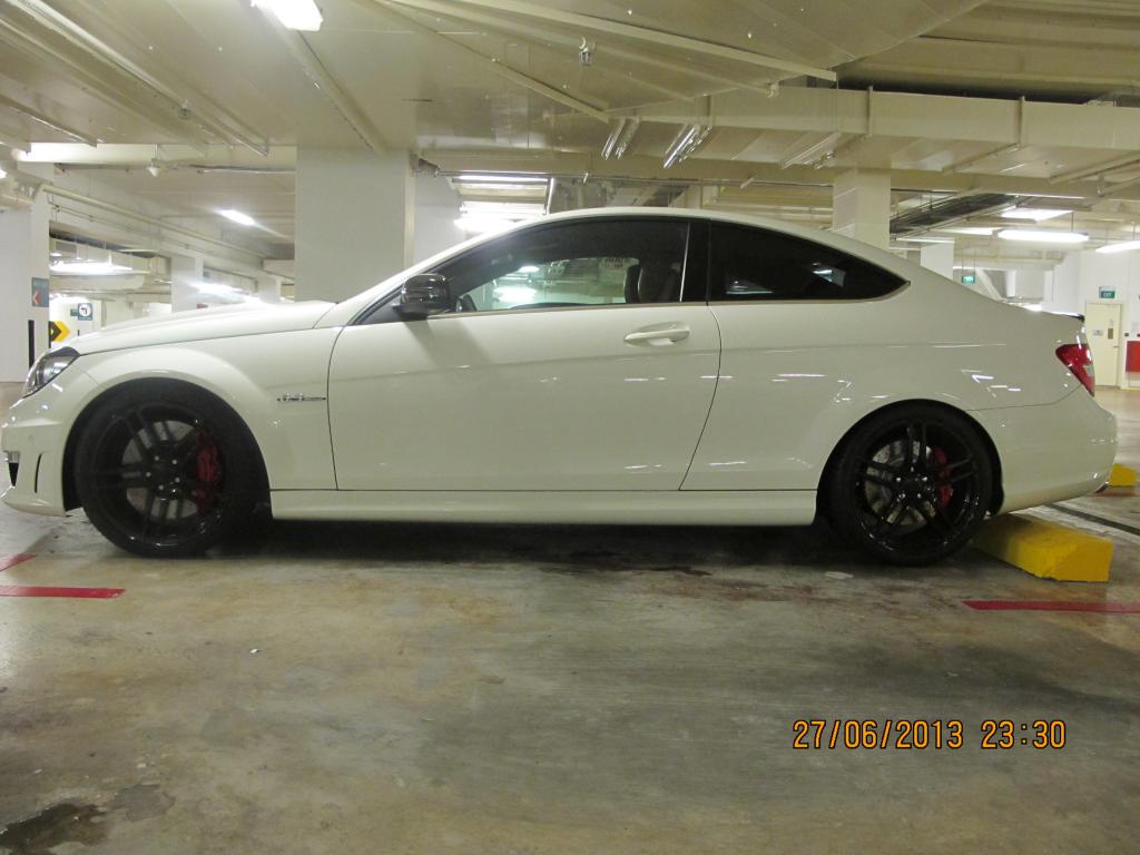

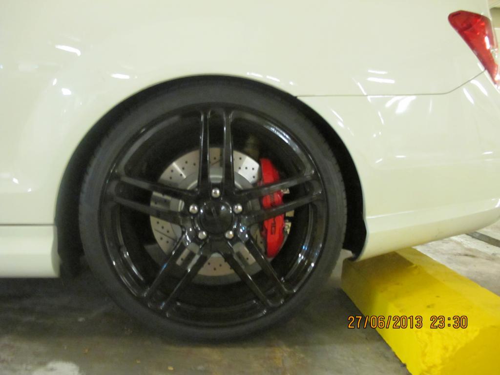

The gap is now 1.5 to 2 fingers......so far so good going over humps, etc...And Car control espeially cornering is superior though ride is a bit rough......

Hi andlee,
R19" Rims Front Offset - 45 and Rear Offset - 50.
Tyre size:  Front R19/255/35, Rear R19/265/30.
Cheers !
ok..i got a more aggressive rear...ET45 with same tyres profile..I see that there is stiill some round to protude out a bit on your rear..
Absolute beauty BKT... loving the stance of your ride!
