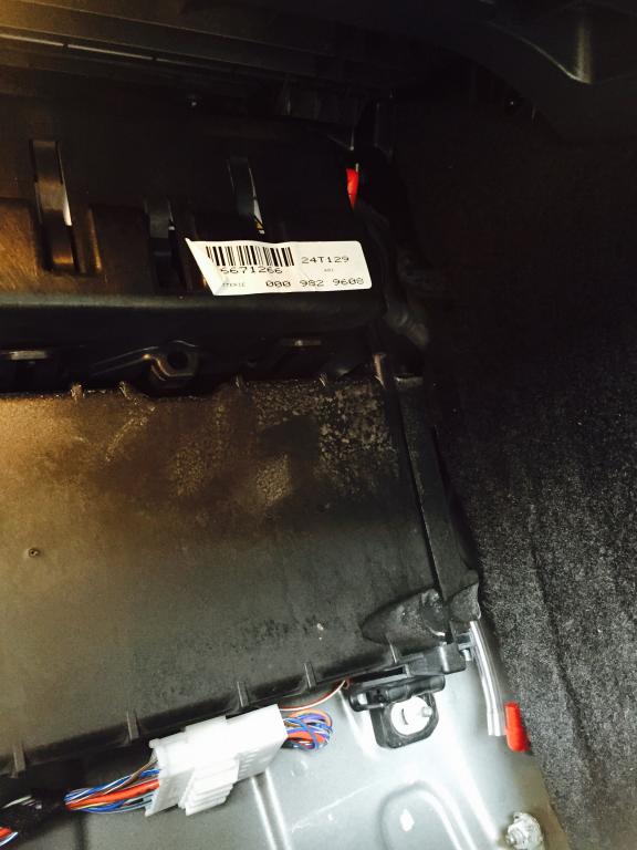

In the case that battery condition is not optimal, the ECO mode should not be active at all("A" logo In yellow, instead of green). By the way, does anyone know where the battery for the ECO start-stop is on the car? It was in the boot on the W204 but can't find it on the CLA.

The Eco batt is a small batt under the front dash. Just lift the carpet of the front passenger floor & u will see it there. It has a thick red cable attached to it.
Thanks jtang, this is really helpful.
