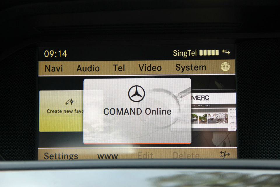

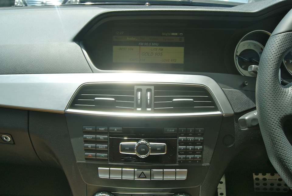

Just want to share with everyone my experience in getting Comand Online NTG4.5 retrofitted.
I see myself as a very IT savvy person, and I love owning the latest gadgets. Have always been jealous of those who've got Comand fitted to their rides. After months of waiting, I finally got the good news I've been waiting for. Received a message from Ricky that he is able to retrofit the Comand Online NTG4.5 system for my ride (W204 Facelift). I headed down to Ricky's appointed workshop, (which also happens to be one of our reputable site sponsor) to get the retrofit done yesterday. Installation was quick and hassle free. No more looking at the tiny Audio 20 screen, the much larger Comand screen gives the dash a more upmarket and imposing feel. Album art from my iPod finally shows up on the screen. The Linguatronic button on my steering wheel works like a charm. After allowing the system to learn my voice, it was able to follow up on all my commands flawlessly, which is a huge plus compared to the iPhone's Siri.
Right after the retrofit, I headed straight to my regular workshop to get an aftermarket Galactio GPS system integrated with Comand. There was some initial concerns with regards to compatibility as the NTG4.5 is a relatively new platform. In the end, my most trusted technician still delivers perfectly. Spent the whole day setting up the system to suit my needs. At the end of the day, it was all worth while. My only regret was not confirming with Ricky earlier that I wanted Video In Motion (VIM) installed. Now it's another two weeks wait for him to ship the device over from HK.
I would really like to give a big thumbs up to Ricky for his excellent and dedicated before and aftersales service. To say the least, I don't think I'm his easiest customer but his patience in providing the best customer service and experience is really commendable.

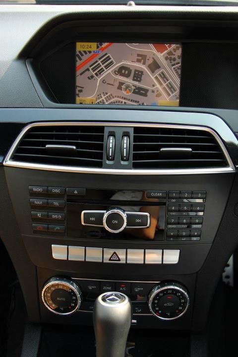

Here are some pictures of the results from the retrofit.
Aftermarket Galactio GPS System

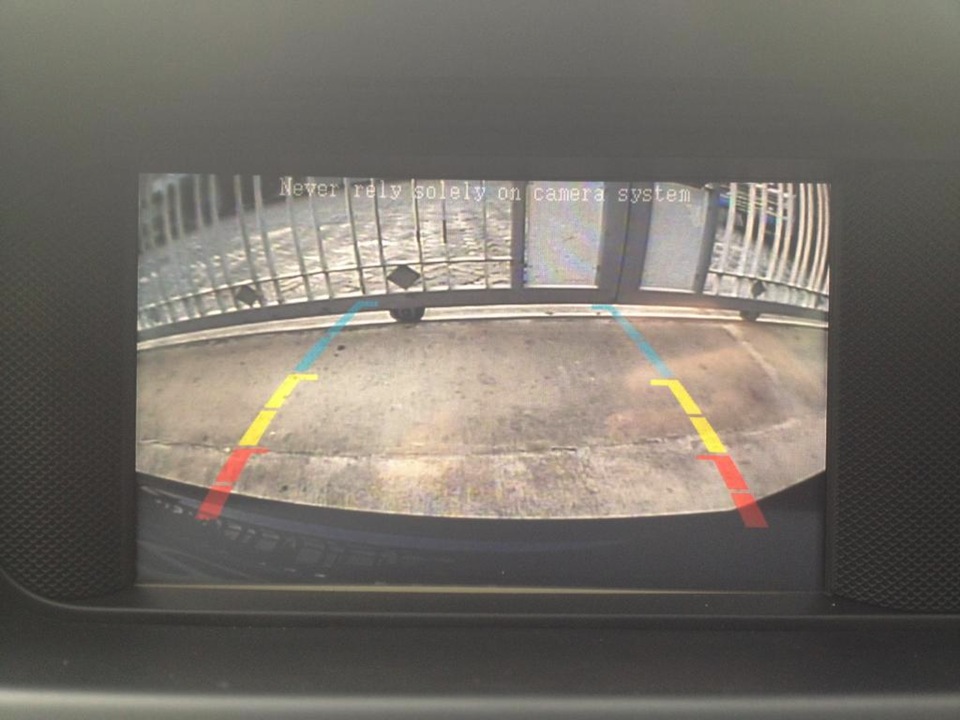

Aftermarket Reverse Camera System (UPDATE: With Guidelines)

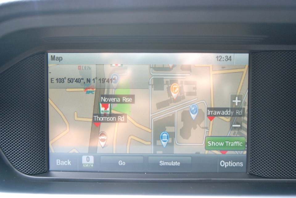

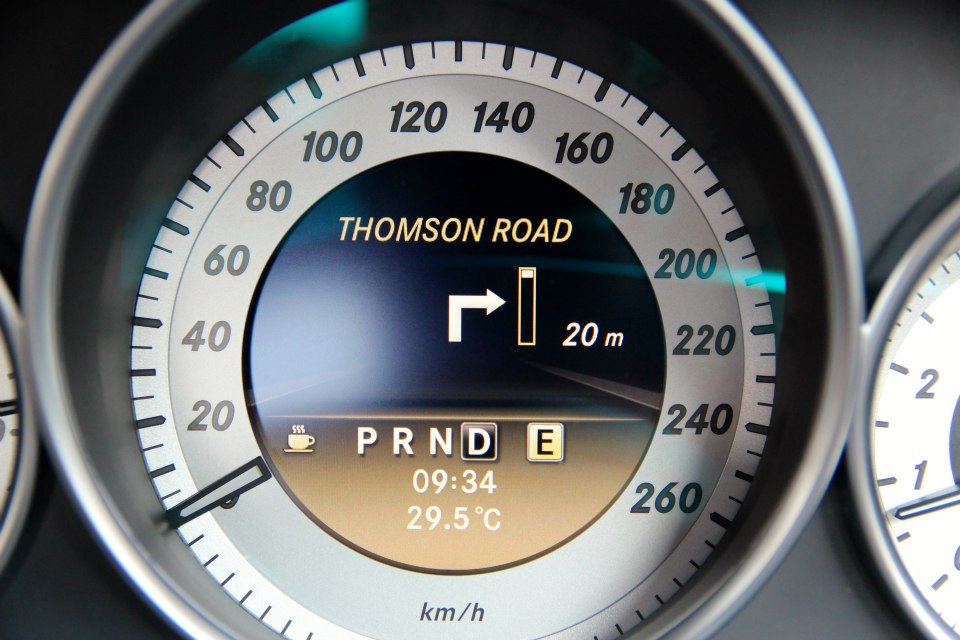

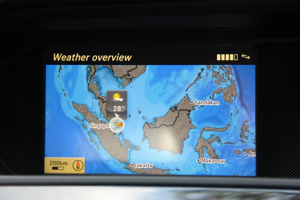

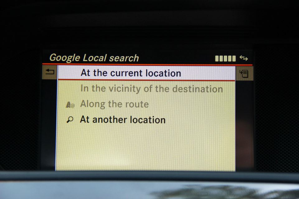

UPDATE: Retrofit system now fully functional with Navi and Comand Online Connectivity

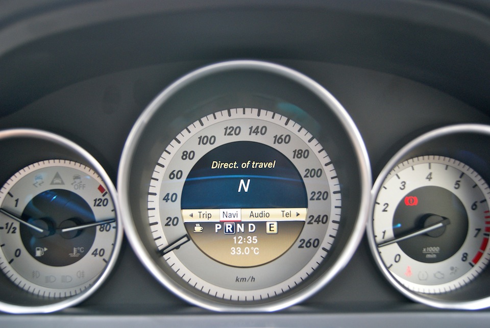

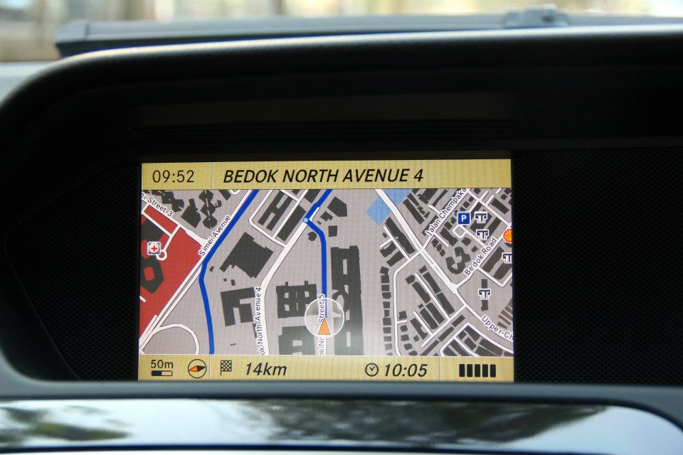

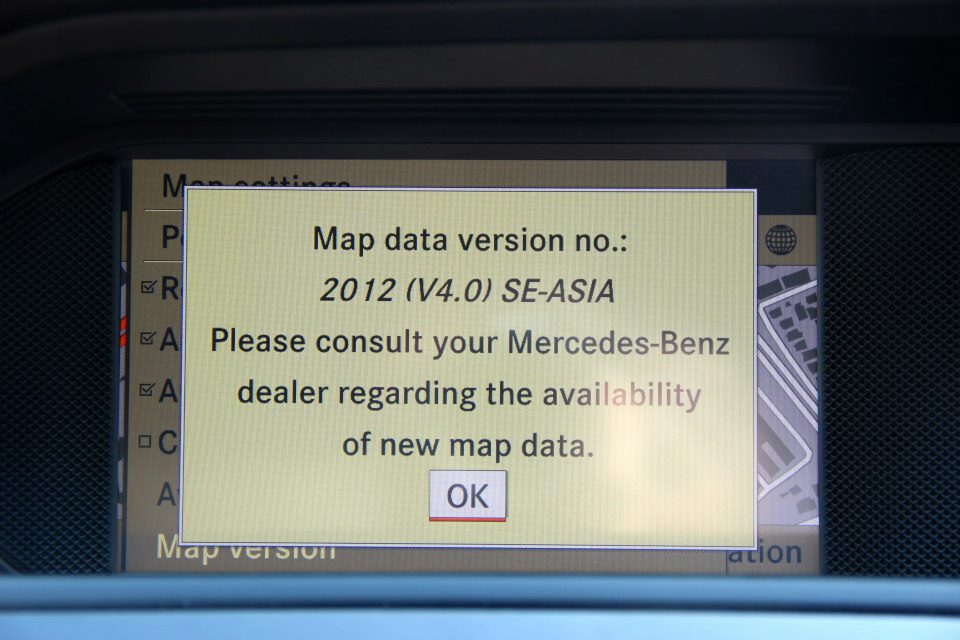

Navi with latest SEA maps
Comand Online

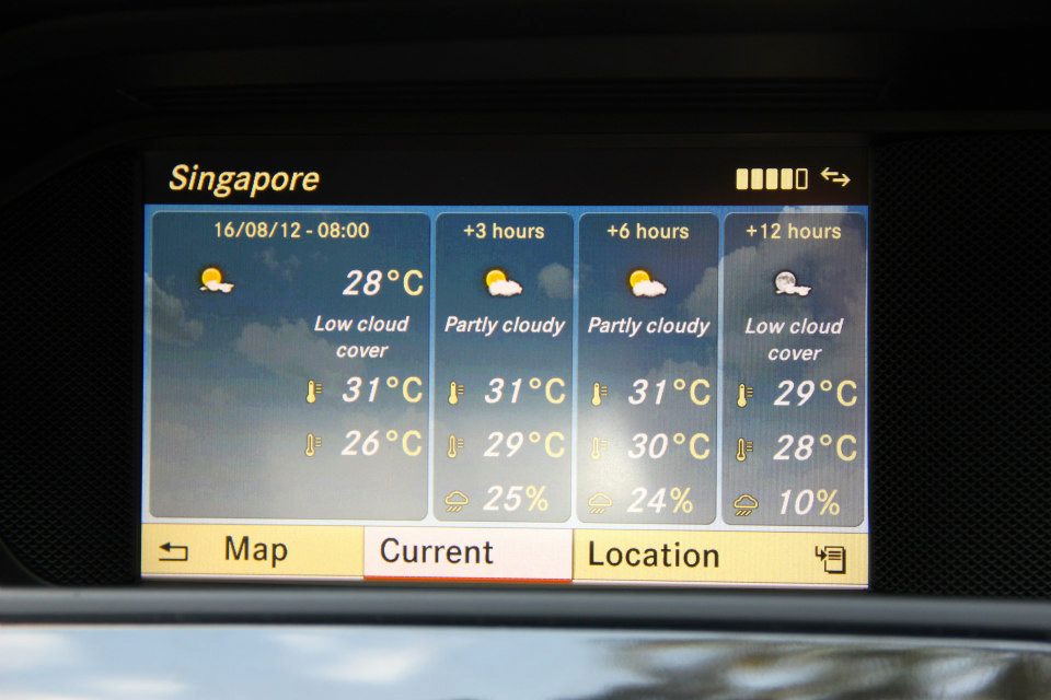

Weather App
Google Local Search

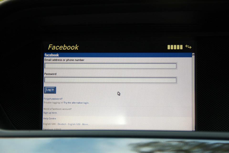

Facebook

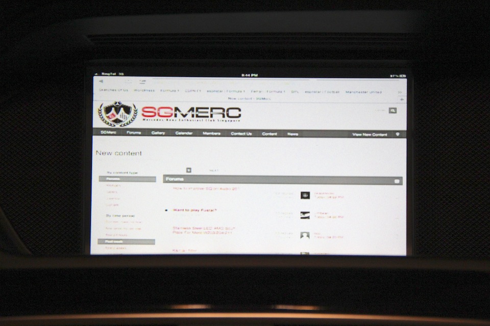

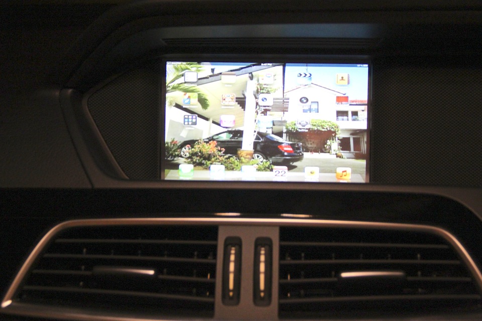

Latest Addition: iPhone & iPod Mirroring
Home Screen
Safari

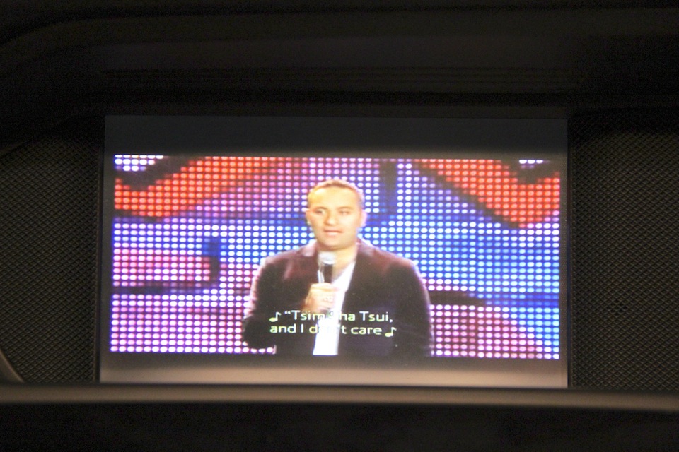

Video

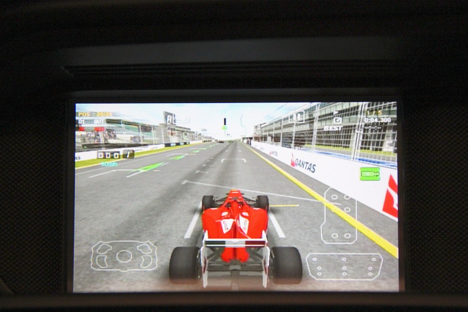

Game
Funny that you're not allowed to do so many things while driving but they allow you to operate an advance computer.

The Comand system does come with navigation. However, maps are not available yet for NTG4.5. IMHO, the functionality of the system is rather limited. One big downfall for me is that it doesn't allow search through postal code. Updates are very slow and expensive. Personally, I feel that aftermarket GPS offers better, faster, and in most cases free map updates, which is more catered to Singapore and Malaysia, but lacks overall integration with Comand. I had actually planned most of my retrofit options on what Bro kepiting1sg has posted in his thread:
It was a huge inspiration and help for me.
Yes! Nav comes with Comand but currently our retrofitters hadn't got a copy of the South East Asia Map for Comand NTG 4.5.
I always like to quote that your GPS is as good as your maps.
The current SEA COMAND Maps are not as comprehensive as the local Garmin, PAPAGO Maps, etc.
The Comand SEA DVD Maps cost $k dollars as compare to $'00 for European or US Maps.
This I guess is due to the number of MBs in SEA Fitted with Comands.
This probably doesn't give Navteq Mappers the incentive to do more work on the SEA Maps.
Even Garmin has to collobrate with MalSingMaps & MalFreeMaps.
One thing superior abt Comand Navigation over your Garmin GPS is that it continue to navigate in tunnel when satellites signal are lost. Comand continues to navigate base on your car direction of travel and speed.

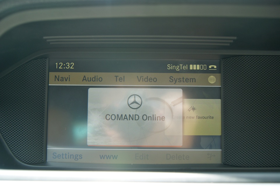

Sorry, some photos aren't really clear as the sun was glaring over my parking spot. Would take better photos if there are requests.
