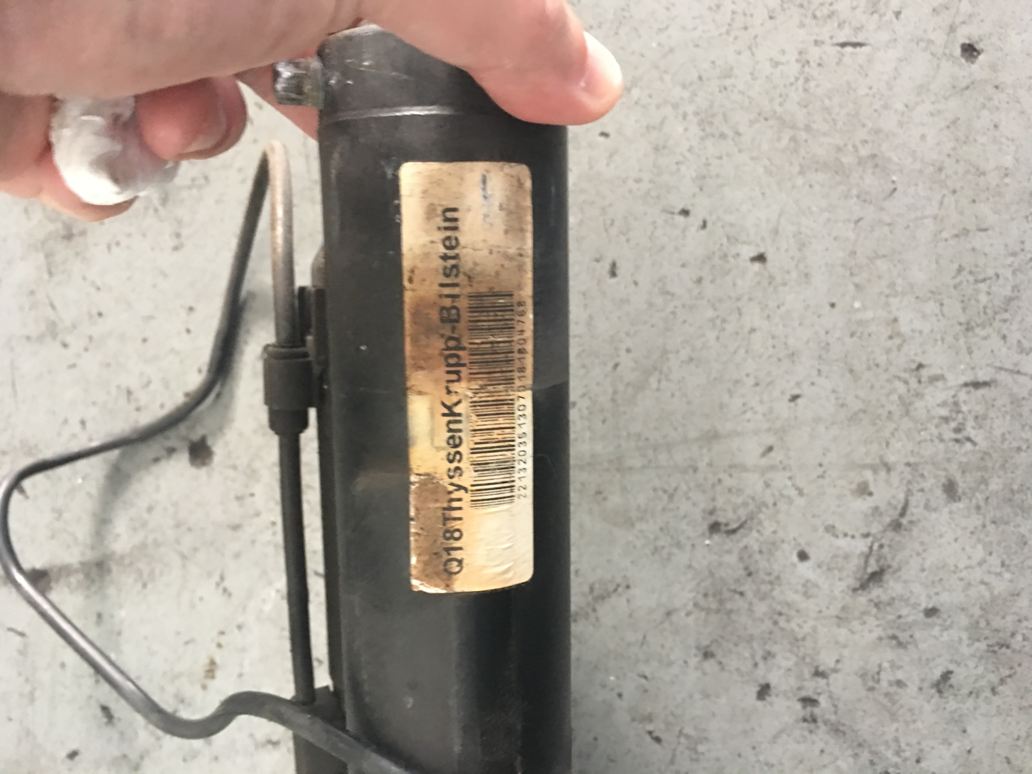

Sad story. Red alert came up last Friday. Stop! Car too low....
Sent in to one of our sponsor workshop.
Diagnosis: Faulty Airmatic Pump.
After change pump front 2 absorber refuse to erect... front 2 absorber also damaged.... gonna change.
Total damage: $5,600.... FML
Bro j888, your advice to change OEM came 2 days late. was really thinking hard if I should just change OEM. Should have just go for it or at least the pump....
OEM suspension doesn't feel any difference from original. That's what i experience when i changed both my original rear to OEM suspension. Btw, the OEM brand is Blistein, which is also made in germany and is a reputable brand. There are others Made In China airmatic selling about $500 which I will avoid.

OEM Blistein $900+ each
MB Original $2100+ each
A little mismatch with your $3334.50 for 2 pieces. My guess is yours belongs to OEM with the seller earning a high profit margin. I have heard of shops selling OEM at $1800 per piece with installation
Could be original MB , check with workshop
I ask for original. He said original 2k each. He gave me some discount. I said ok install original. Now i realise it blistien. That was in june. What can i do? Its one of our site sponsor somemore... damm

Just changed both front airmatic shocks at C&C. Total damage around S$9k. Tried to get OEM version outside but was told there was no stock in the whole of Singapore. After I collected my car from C&C, got a call from Chip Soon telling me that they have stock and can do it for under S$4k. Only difference is C&C gives two-year warranty but OEM shocks come with no warranty.
However, I have to say that after I collected my car and drove it, I was really impressed. The car feels brand new. Super smooth, quiet and comfortable. I'm very happy with it.
Can PM the workshop for this?
I took my car to Chip Soon to have front suspension control arms and air suspension pump changed. They did a very good job and charged a lot less. Also used Mercedes original parts.  Funny thing is, they looked at the air suspension I bought from C&C and told me it's NOT the original Mercedes one.
