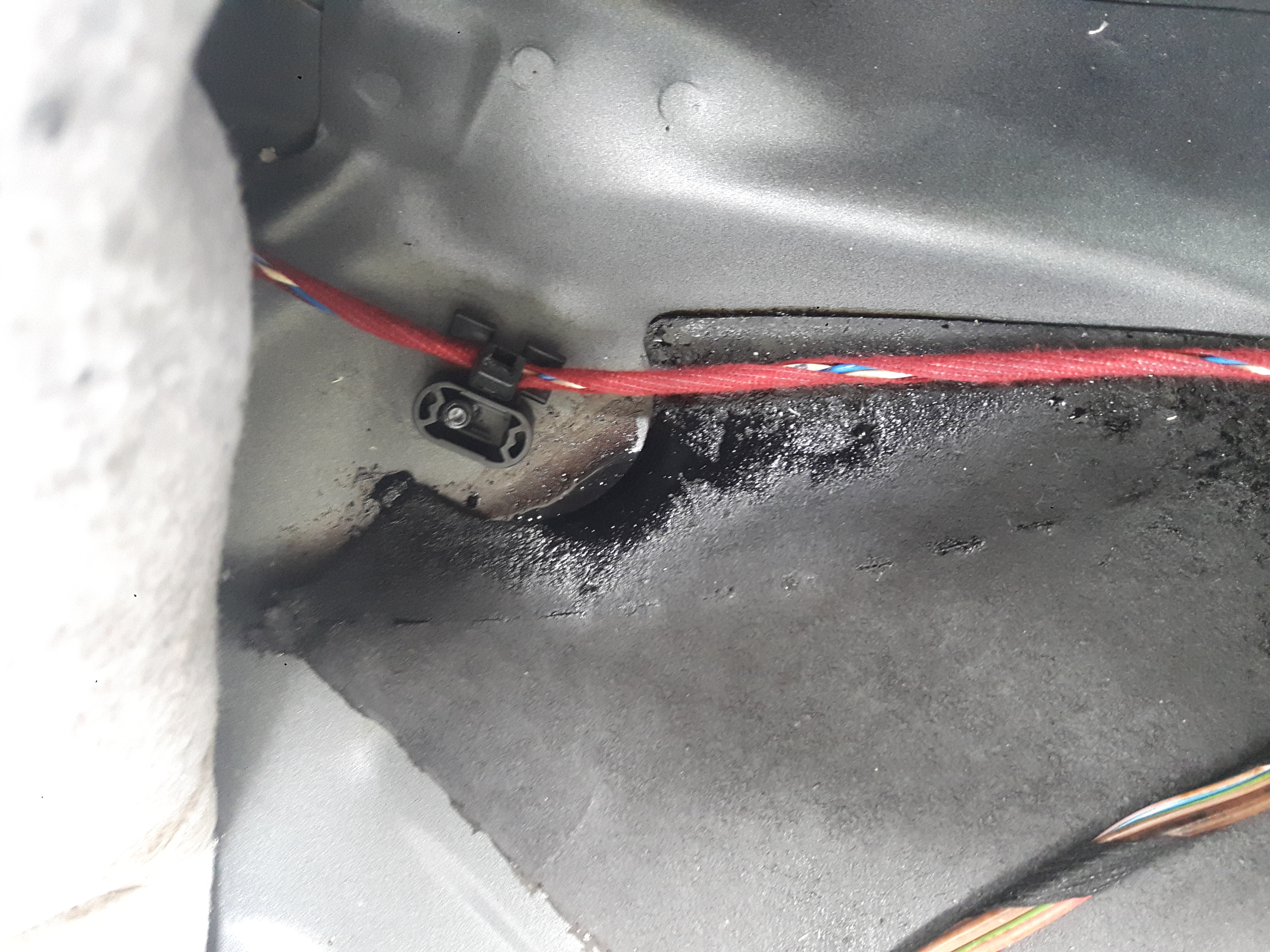

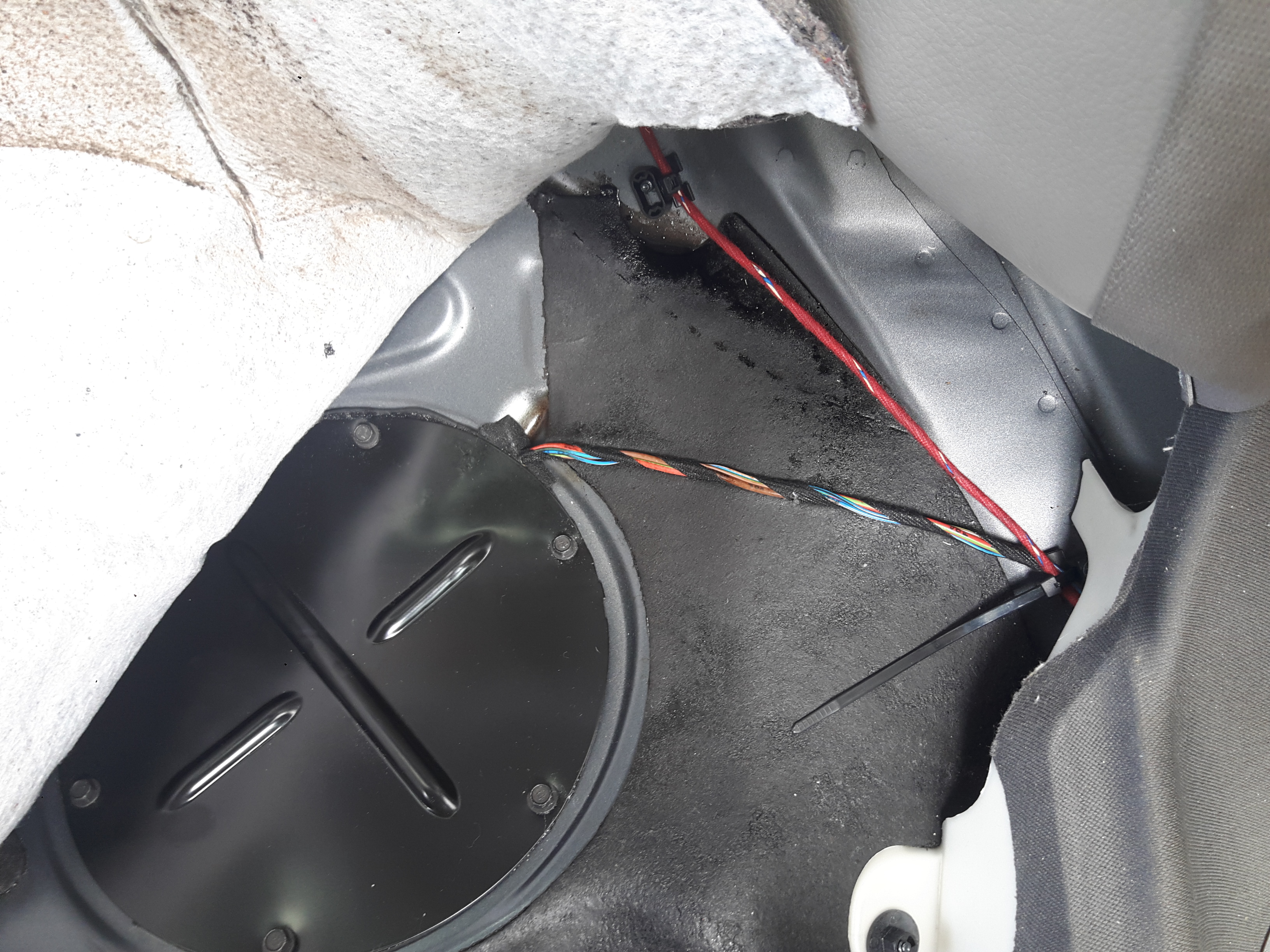

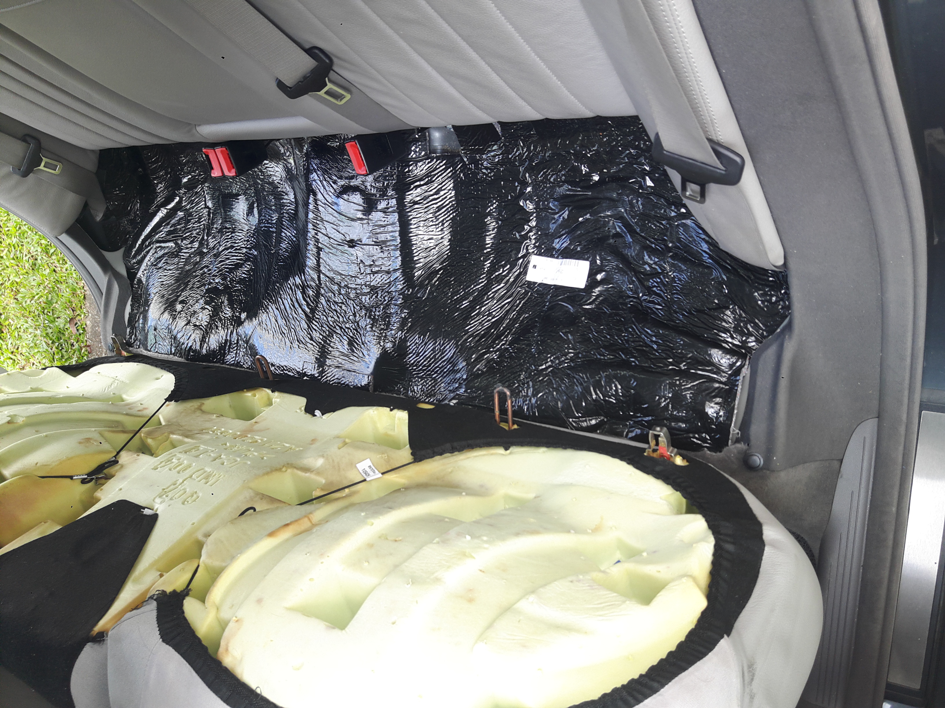

Hi W211 bros,
I faced this petrol smell since yesterday night and the fuel odour has become unbearable. It happened after a full pump at one Shell petrol station in JB.
Mine is E230 Y2007 July.
Will attempt to resolve first on my own to avoid "kaboom" situation.
Any bro here care to share what is the repair patch?  Still available for $300. Its far better than replacing the whole fuel tank right? :0
I open the rear bench seat and think i  found the problem spot. See attached photos. Haven't have time to open up the fuel filter round cover for cleanup.
