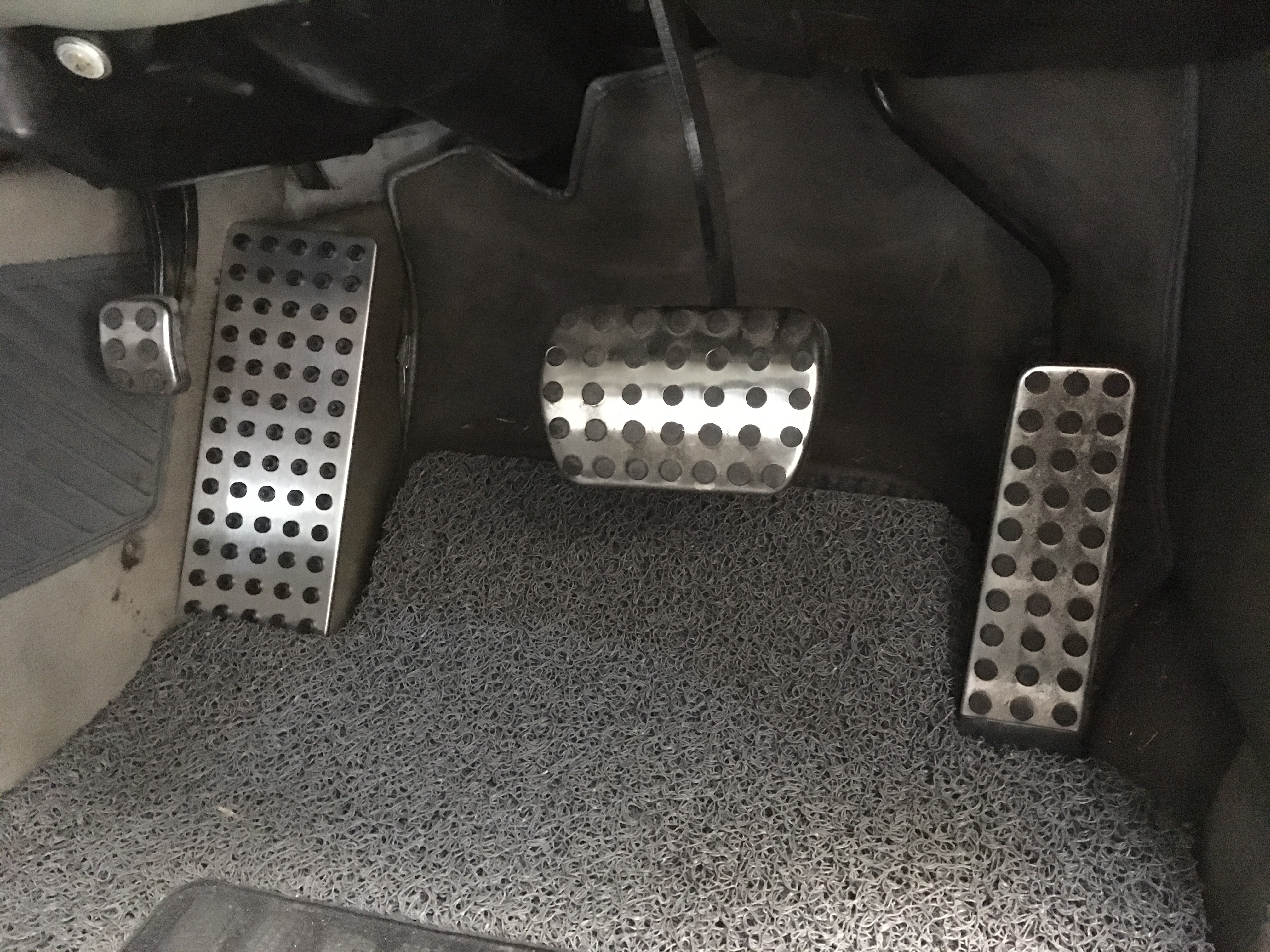

The difficult part is getting out the accelerator pedal as you do need to remove all the carpets and wiggle the thing out. The carpets are easily removed by just lifting them up and sliding them away. This will expose the metal floor and you will need to remove a small plastic clip at the base of the pedal. You can then lift the pedal off its base and swing it to the left. The hole behind the rubber is slightly oblong which allows it to slip out when in the right position. The picture below shows how the hole is shaped and should give you a clearer understanding of how to remove it. Whatever you do, do not use bull strength to force it off the assembly.
Now that you have removed the accelerator pedal assembly from the car, you will realise that the aluminium pedal cover is slightly smaller than the W124 version. This is why we need to modify the W124 pedal assembly to make it fit.
Firstly, you will have to remove the W124 rubber cover and the aluminium one from their respective assemblies. The W124 one slides out but you will need to cut through the rubber on the aluminium one to slide it off. You then use the aluminium cover to estimate how much needs to be cut off on the W124 assembly.
The W124 assembly is made of plastic and I used a heated pen knife(hence the stove) to slice through it. I took about an inch off the top and slightly less than half an inch off the sides in total. Take a tiny bit off at a time and use the aluminium pedal cover to check each time you cut through. There is also a small lip at the bottom of the plastic assembly that i removed so that the aluminium pedal cover can slide all the way down and sit nicely on the assembly. Clean the pen knife on the old news paper each time you cut to remove the melted plastic and re heat the pen knife as you go along. Do it in a well ventilated area as the fumes from the melted plastic is probably quite toxic and you wont want to breathe too much of it in.
The finish product should look something like this. Do not cut too much off the pedal assembly so that the aluminium cover fits snugly and wont slide out while driving. You could also put some glue at the back to hold it in place more securely but it was not necessary for my case.

I didn't cut the aluminum rubber, used WD40 to removed and fixed back original with ease.
Thats a great idea! I didn't think of that when I did mine... darn. Mine is still very tight though and they have been working great. The shorter accelerator pedal kind of makes it more sporty? Haha im not sure whether a W124 can be called sporty, but it definitely makes it easier to step more gas.
