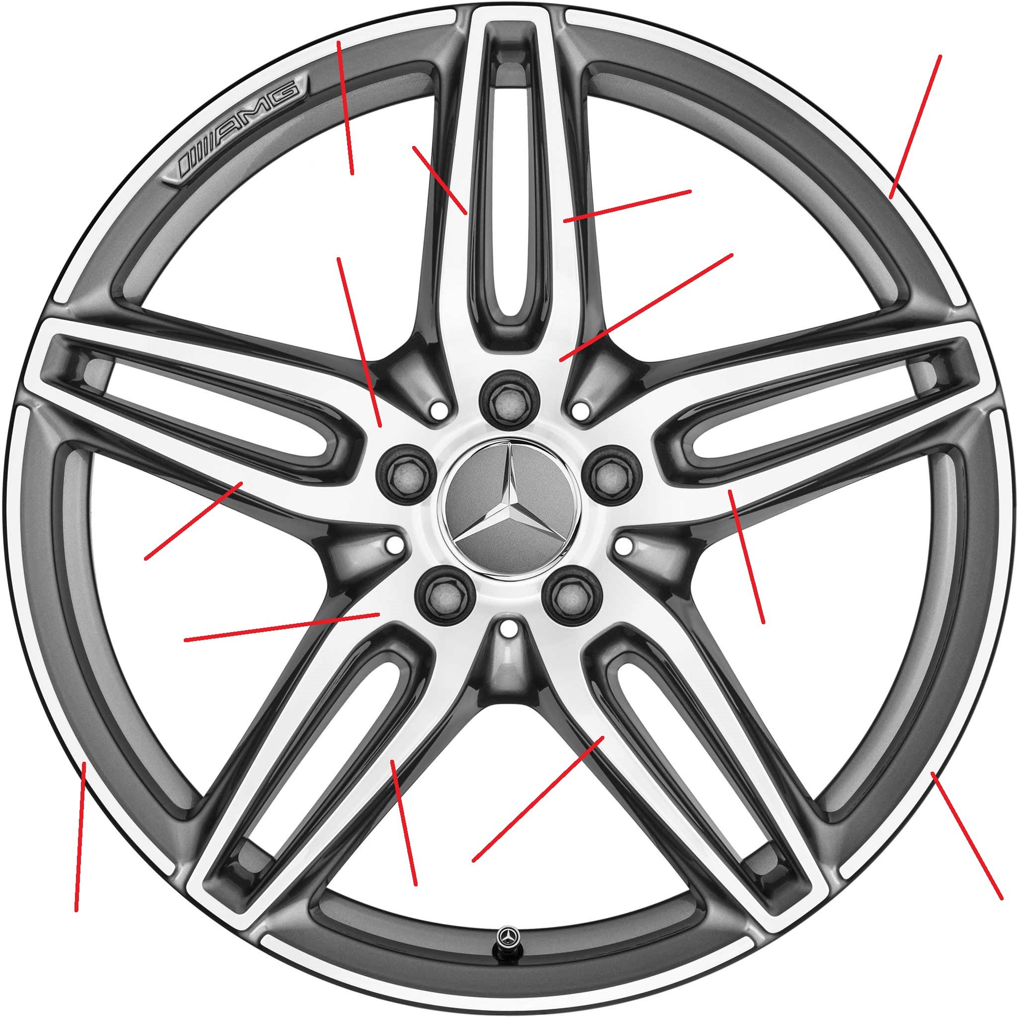

You see a picture of my amg rim surfaces highlighted in red lines.
These are the high sheen surfaces created by very fine machining processes on multi axis CNC Machining Centre or CNC Mill.
Any spray paint job on these surfaces, the high sheen finishing will be gone forever unless you do a re-machining by skimming these surfaces to get back the original high sheen finish.
This will need a very knowledgeable machinist/engineer and good CNC equipment.
With more losses of the original material, wheel can be badly out of balance.
You will need also the original 2D & 3D drawings to assist in the programming of the machining process.
This will also end up to be more costly than buying a new set.

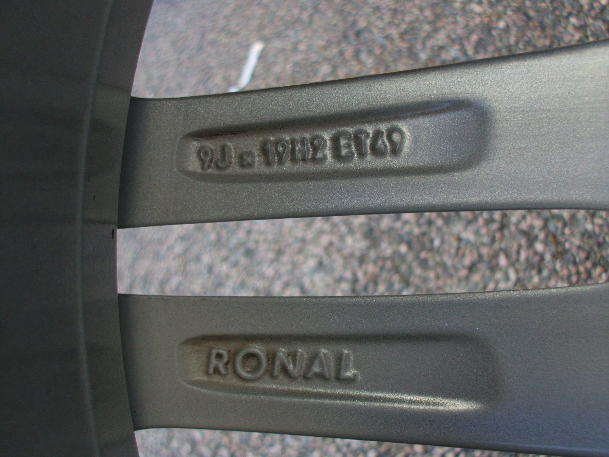

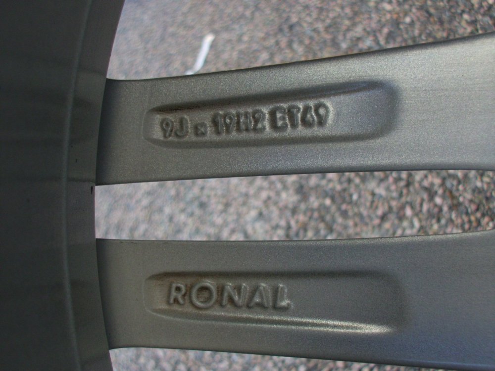

Rims are not manufactured Diamler Benz but usually by this OEM company RONAL. (appears on most AMG rims with the imprint on the rear of the rim)
