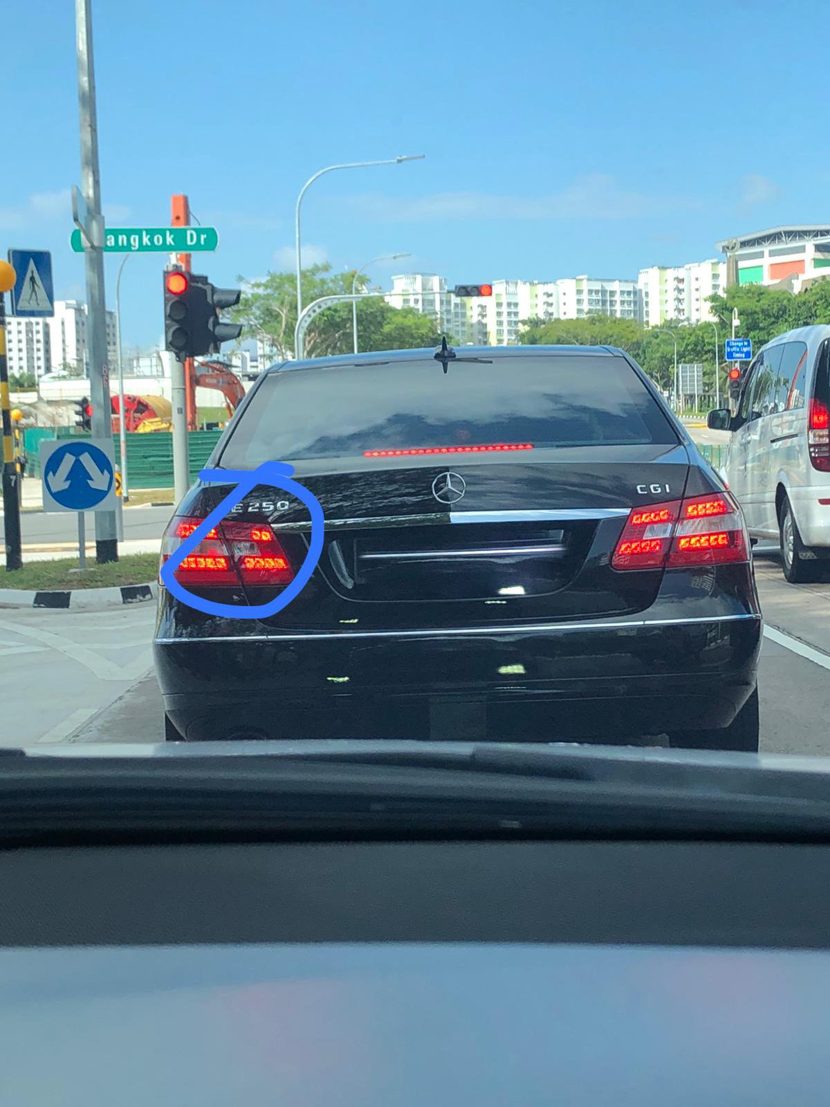

Hi all
would like to know if  I would need to replace the whole led system for my spacer.pngW212 prefacelift version or just a blub as attached with the picture as I can’t find the  answer on Google or YouTube
Thanks in advance
This's a known issue for PFL W212 7-Gtronic left side brake lights starting from Oct '11 to FL in 2014.
Didnt affect PFL W212 5 Speed from 2009 to Sep '11.
You might want to buy a similar light panel from pre Oct '11 PFLW212 from the local scrap yard - our site sponsor Propel Autoparts
