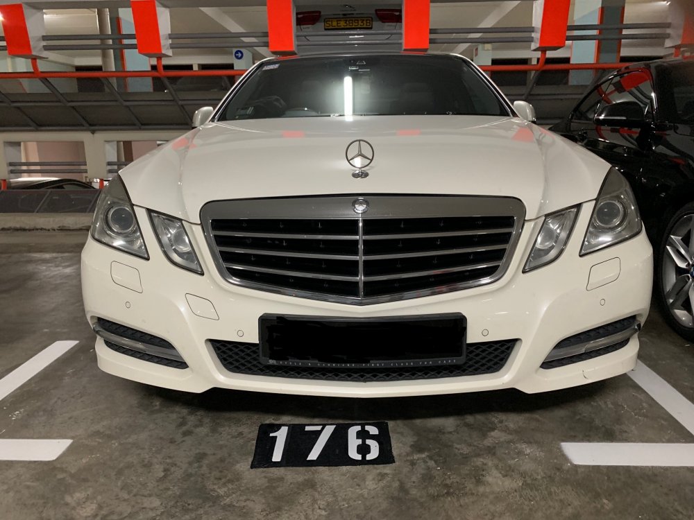

Is the front of your car front looks like this without fog light but with DRL and the grill with the same number of slits?
If yes, likely to be avantgarde

Thanks for the detailed explanation Bro... mine is definitely not an avantgarde... cos the interior is brown wooden finish and my aircon control has "Elegance" logo there... but the entire car was fitted to look like an avantgarde with all the bodykits and DRL fog lights etc.. workshop also confirmed that headlights has been changed to HID...
