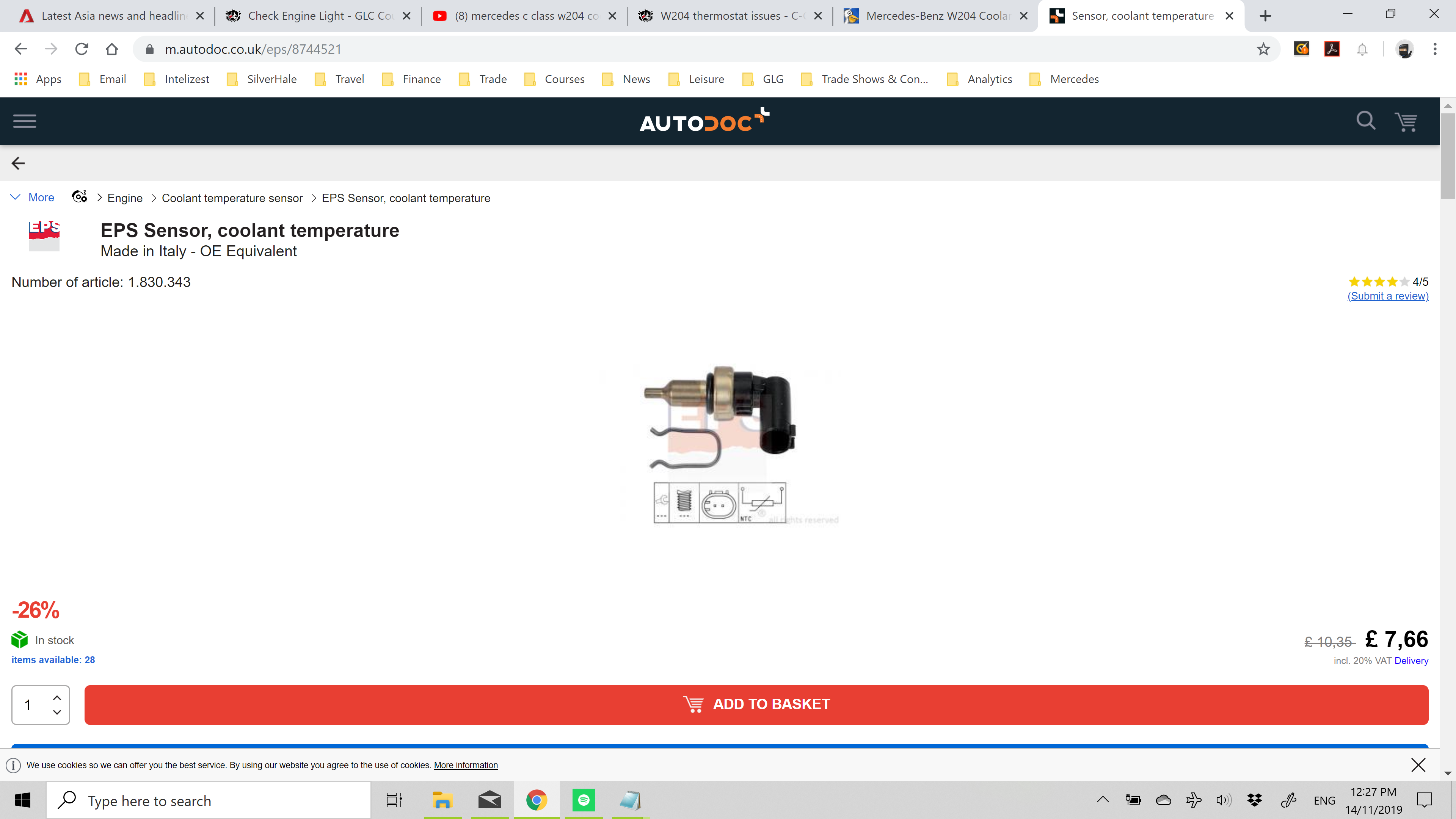

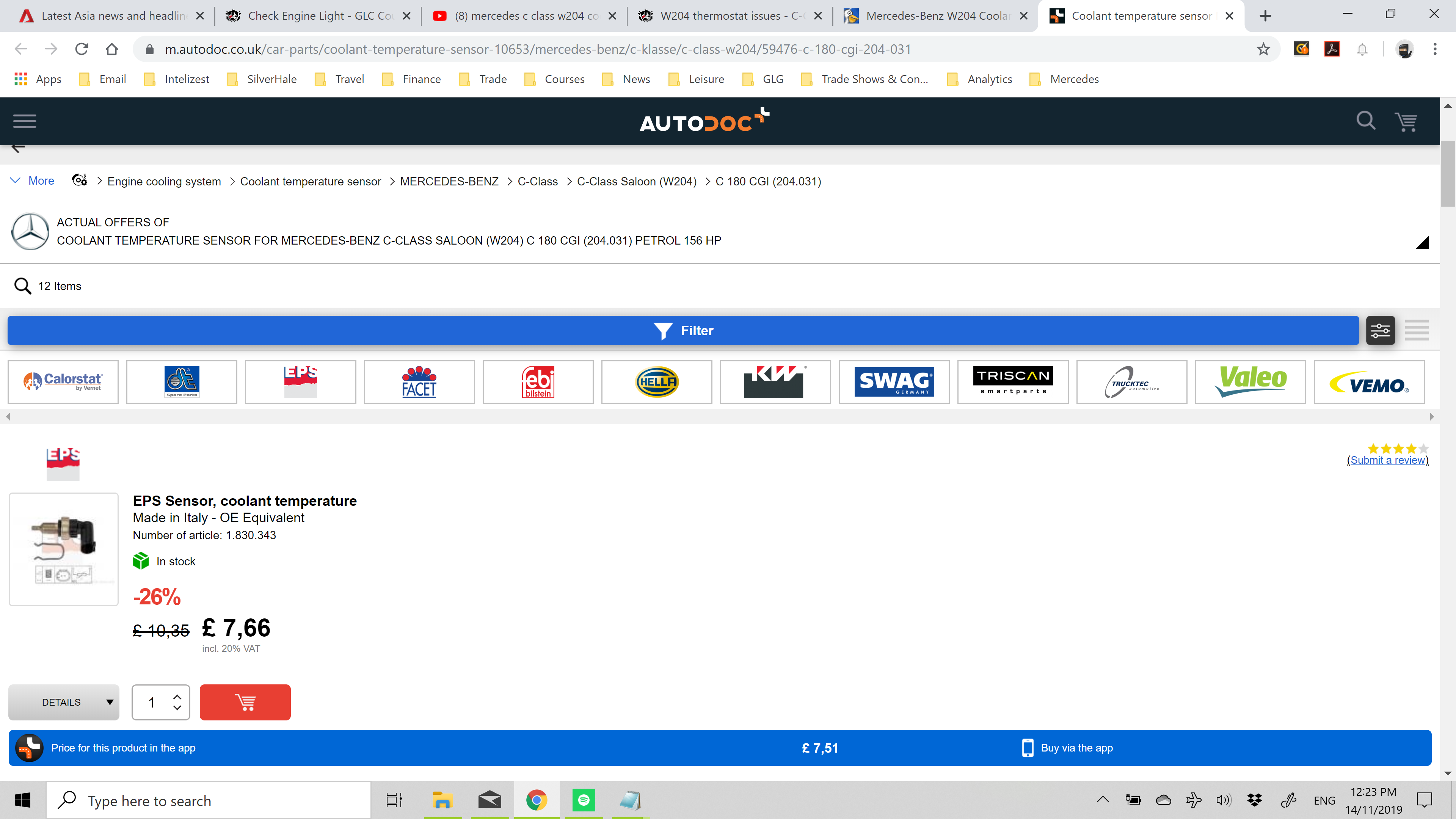

Hi, does anyone know if you can just replace the coolant temperature sensor, without replacing the entire thermostat housing (about $400+)?
C&C will only want to change the whole thermostat housing. I don't know if anyone has done it in local workshops, but seems like its very easy to just change the sensor only which is what most in the west will do https://www.pelicanparts.com/techarticles/Mercedes-W204/37-WATER-Coolant_Temperature_Sensor_Replacement/37-WATER-Coolant_Temperature_Sensor_Replacement.htm. Of course, not much money to make the workshops i guess.
But just curious if anyone has changed their coolant sensor only in Singapore? Mine is a C-Class 1.6 Turbo 2013 W204
