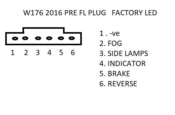

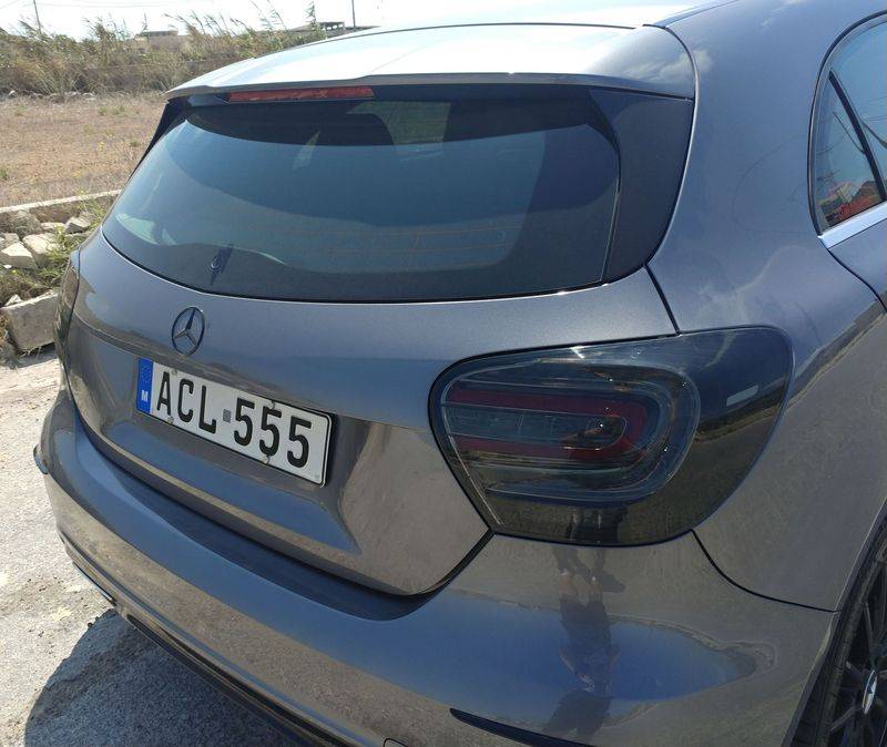

Dear all I am new here and I am looking for some help as I got myself a set of smoked rear lights aftermarket (for my pre  FL a class) . I have a pre facelift 2015 my car came with leds as standard and the lights I am trying to fit are also led.
original light cluster:
smoked rear light cluster:

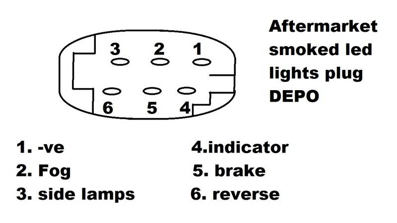

after market plug ( pre 2015? )
could anyone guide me in the right direction in regards to a wiring diagram or colours? and if an adaptor exists?  the both seem to have 6 pins  although on the plug fitted to the car these are in a straight line compared to the other which has pins on 2 rows. Thanks in advance.

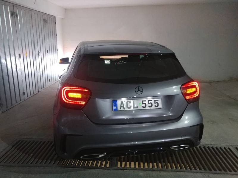

If anyone is interested I managed to get these up and running, I didn't find any help online so I decided to tackle this with a mate :
I bought the smoked lights from FK automotive in Germany but the lights are made by DEPO Taiwan
The aftermarket lights have a foglamp on each side so they will work irrespective if the car is left or right hand drive.
we had to use a soldering iron and solder cables to the pins of the aftermarket lights and we did cut through the factory plug and crimped universal aftermarket plug 6 pin which
you can buy from most auto shops,
similar to this one: https://www.aliexpress.com/item/Fema...811683989.html
oem/ aftermarket lights pins as per pics
