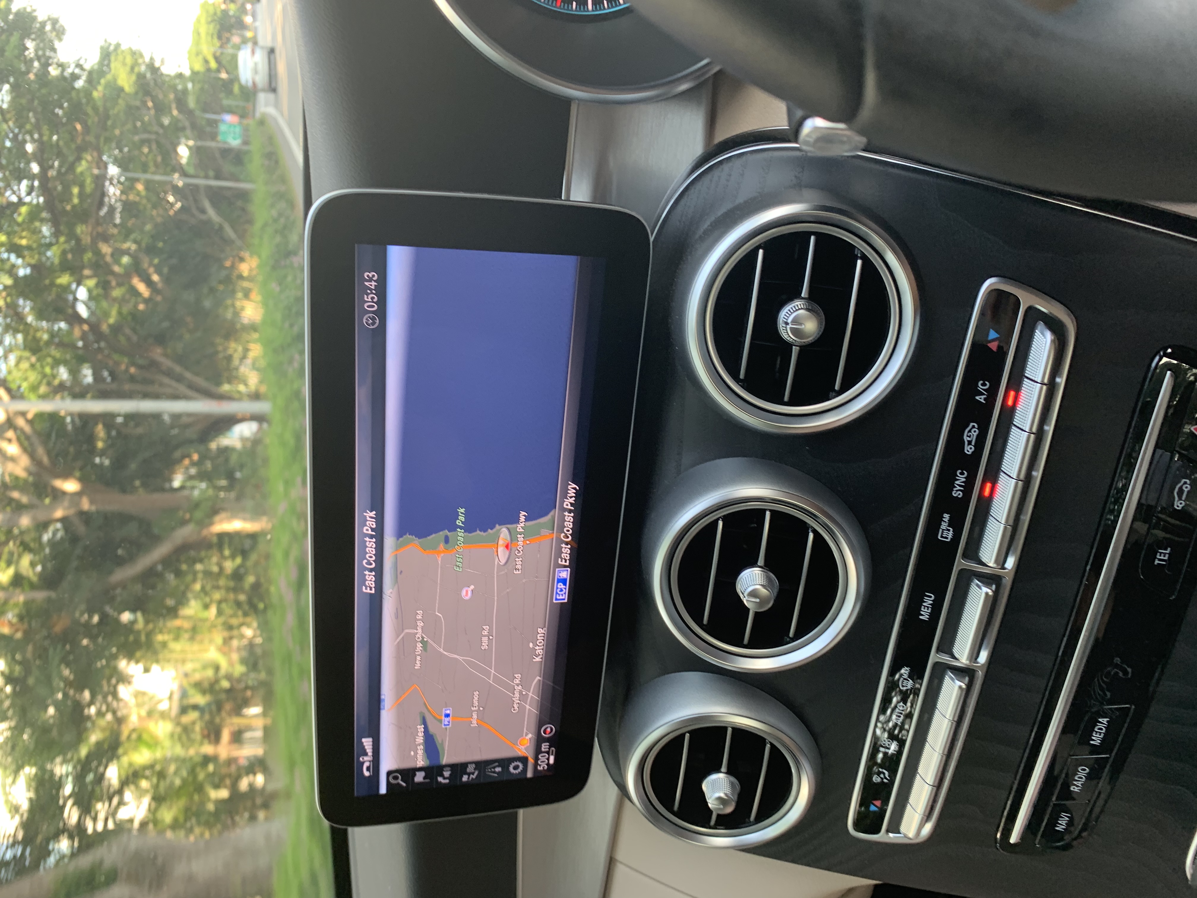

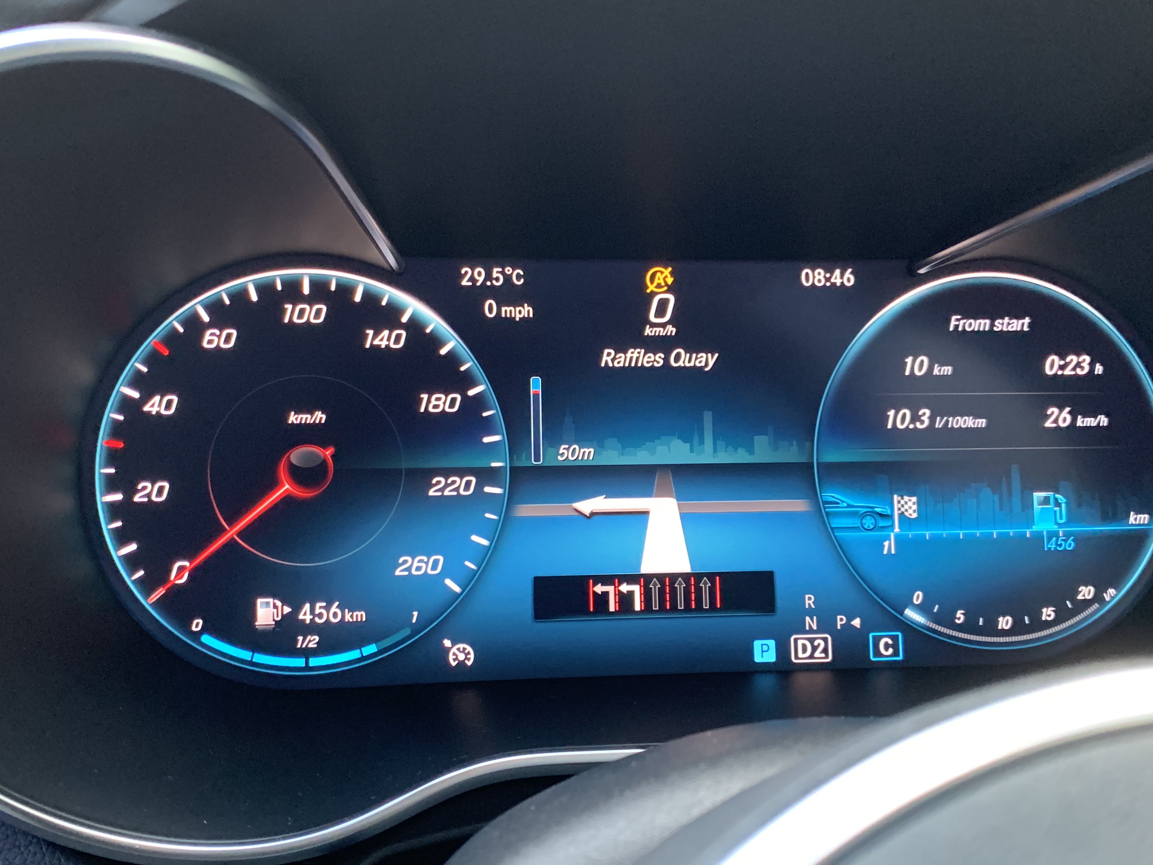

contributing my share as I have benefited from this discussion. It works for me, and I’m driving 2019 FL W205 too.
It is integrated to instrument cluster as well. :)

I just received my card and inserted into the SD card slot but nothing happened.  Can you explain the installation procedure?  Thanks.
Hi Gusheng,
. Here’s what I did with the card:-
1) inserted the card
2) power up the audio 20 system and was prompted to update software with Navi 2.2 for NTG5.5. Proceed with update and restarted audio 20
3) once audio 20 is restarted, I pressed on the Navi button on the console and recv the prompt that the card will be tied to the vehicle if I decide to proceed.
4) I proceeded and navigation works as expected.
