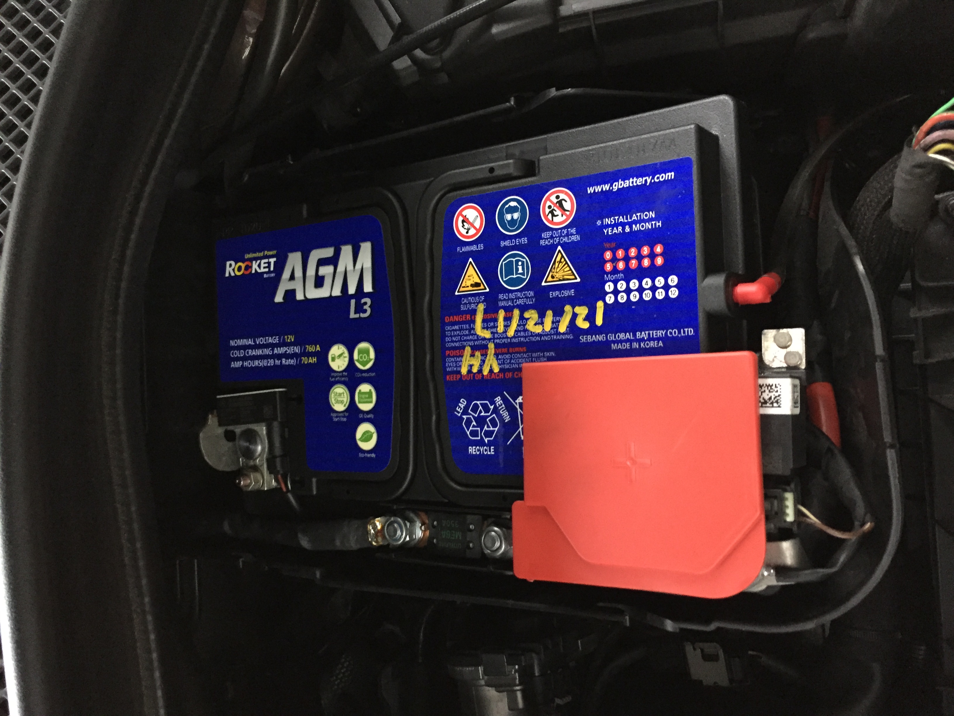

After I changed my battery to Korean brand type. So far so good. So far No engine warning light. Hope it is all because of weak battery.

My batt was original batt from MB. Yes MB used Varta. This Korean brand batt is deep cycle batt too. Anyway Varta died off so fast so it doesn’t matter what brand to use. And no warranty from MB if change with other workshop so Varta no Varta it is ok for me as long as it serve the job. My friend intro many to conti car user so far no bad feedback .

Do you mind telling me what brand the battery is? If it has the same specs, I don't mind trying the battery.
