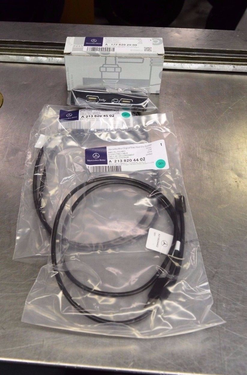

anyone with good information to share how all our C class users can cheaply benefit from the installations?
Elebest recently did it and the video is online, but he quote me $2000, for an add on. I'm kind of taken aback. Or maybe he has to change the whole Audio 20 set meant for an A class to a C class.

car-play.pdf

typically MB USA confirmed that they are releasing Apple Car Play for Audio 20 set for C class. Typically its just a few cables.
Appreciate people with more information to step forward to share and benefit the rest of the C class users.
By now, has MB released a kit for Apple AirPlay on W205?
Alternatively, are there different versions in OEM?  Where to see and compare some specs?

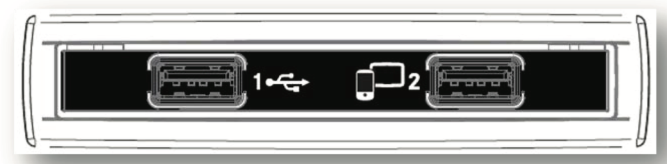

If your USB ports with 1 that is similar to USB Port 2 (sign of phone & tablet) - Your car is installed with Carplay/Android Auto and possibly not activated.
If not, then you might have to retrofit Carplay

Mine has only 1 USB port.....it's a 2016 model. -_-

IMHO
3 choices
a. After market multimedia box - mirroring + apple TV
b. Change OEM COMAND HU with Apple Carplay - need coding for vehicle to accept new HU
c. After Market Android HU
