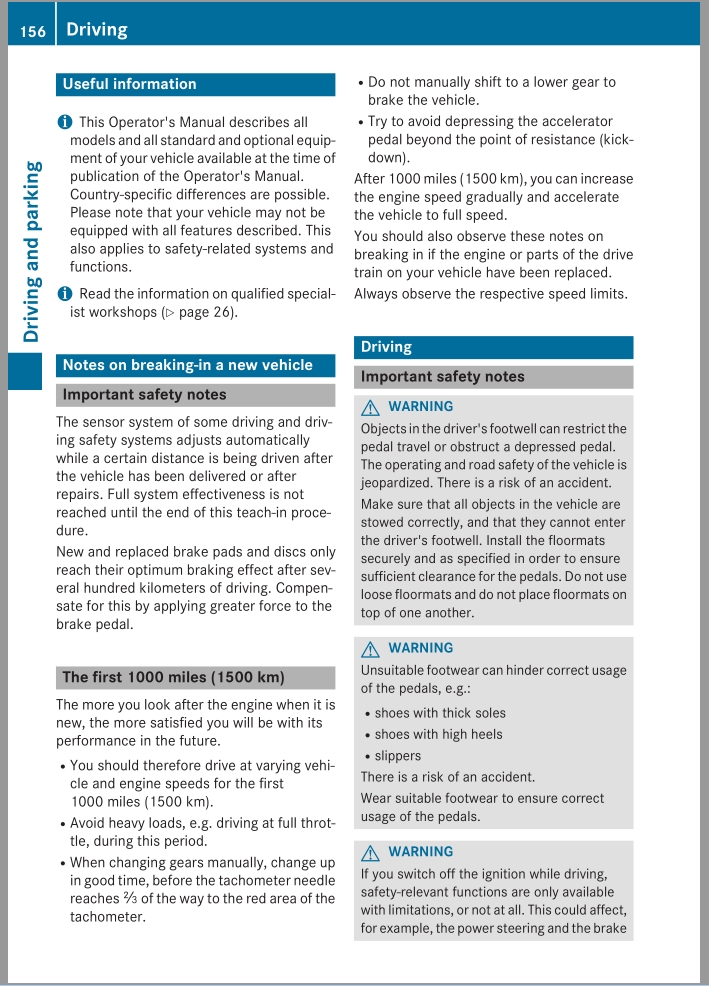

Yes indeed, after finding a GLA manual online you are correct (sorry, not opened mine yet, too new and too slack lol)
https://carmanuals2.com/get/mercedes-benz-gla-2017-owner-s-manual-97267
Additional breaking-in notes for Mercedes-
AMG vehicles:
Do not drive faster than 85 mph
(140 km/h) for the first 1,000 miles
(1,500 km).
Only allow the engine to reach a maximum
engine speed of 4,500 rpm briefly.
Change gear in good time.
You should also observe these notes on
breaking-in if the engine or parts of the drive
train on your vehicle have been replaced.
