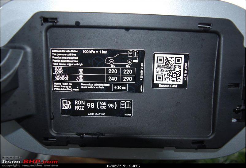

tyres are bridgestone RFT 235/55/R19.
according to the instructions, normal to pump pressure to 220 for all 4.
is that sufficient?
my ex-car was on 225/40/R18 and pumped 250 (recommended by tyre shop).
Not sure of the technicals, but i'd just follow what's on the label - i.e. full load then 240/290, normal load then 220.
is that sufficient?
If I am not wrong, the figures are for tyres when cold. So you should pump about 240-250 there abouts if you pump at the petrol station after a long drive.
My TPMS will show 220-225 all 4 wheels when cold and when warmed up will hit 245-250. I noticed my rear 2 wheels tends to be of higher pressure than the front by about 5-10kPa.
if you see the label in detail, it says exactly what I observed. To add +30kPa when tires warm.
