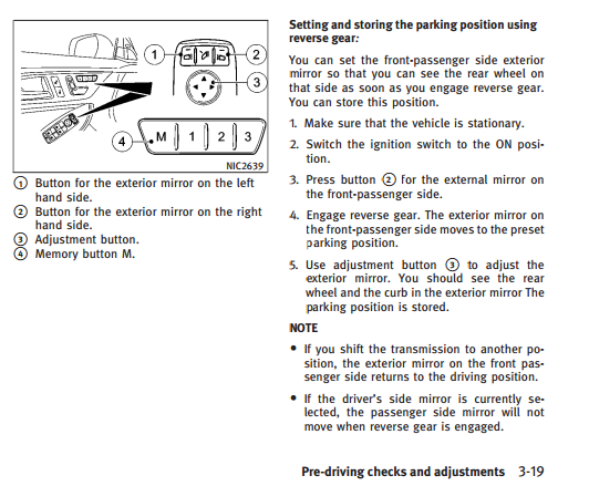

I went through the steps but somehow it does not work for some reasons :(
Wonder where I went wrong?
Mine is 1 year old A200FL. I tried the instructions.. with key in "on".. i couldn't engage reverse.  I had to start the car and it worked.
Thank you! It seems to work but how to make the right side mirror tilt downwards instead of the left? :mellow:
Driver's side mirror cannot tilt downwards.  Only the passenger side mirror tilts to help you see the curb. I just wind down window and look out for the driver's side. 😁
