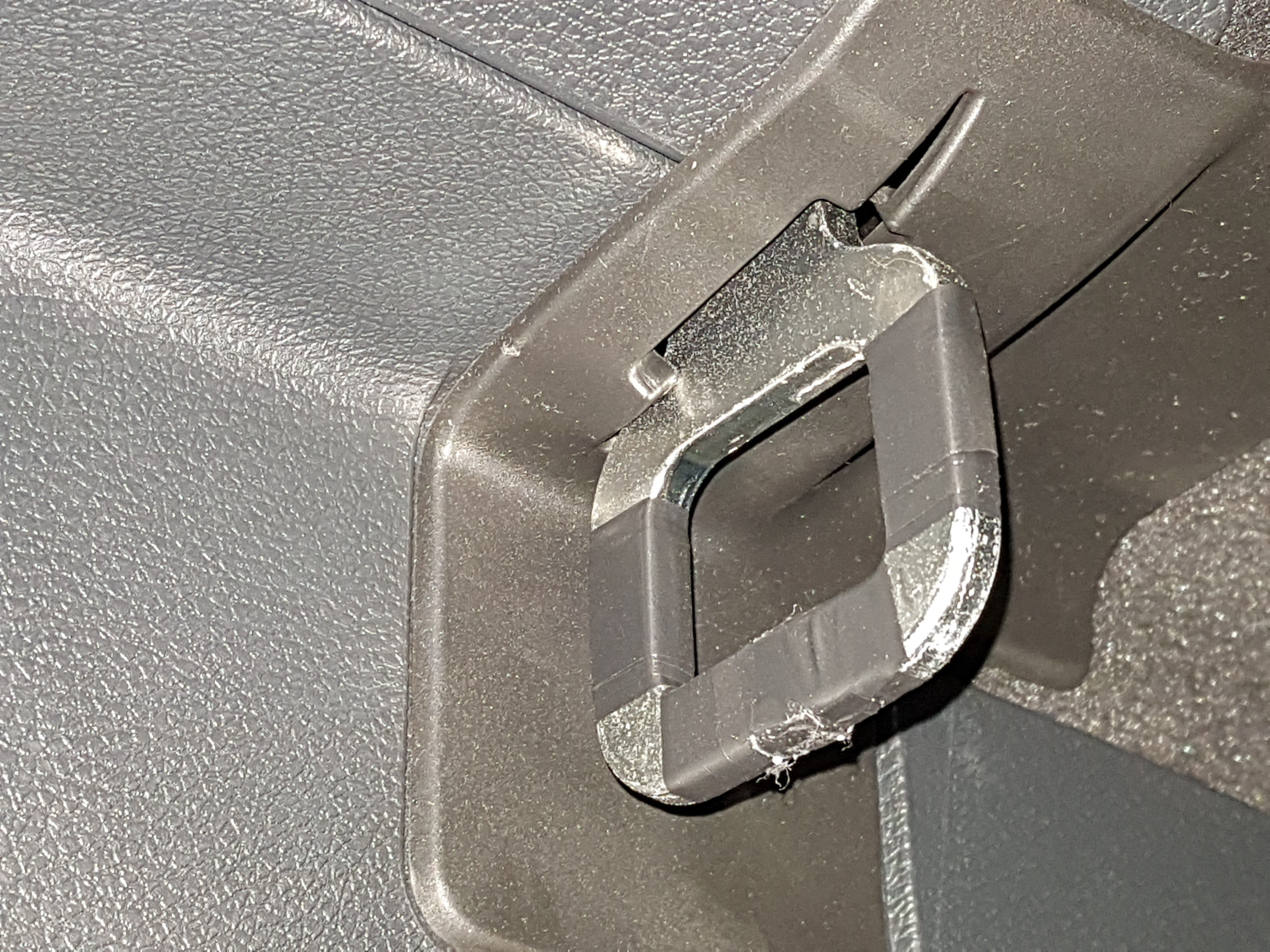

Here you go... Simple job. But not sure how long it will last.
The length of the tape I used abt 4-5inches. I think any longer, the wrap will be too thick n u will probably have trouble latching the seat back.

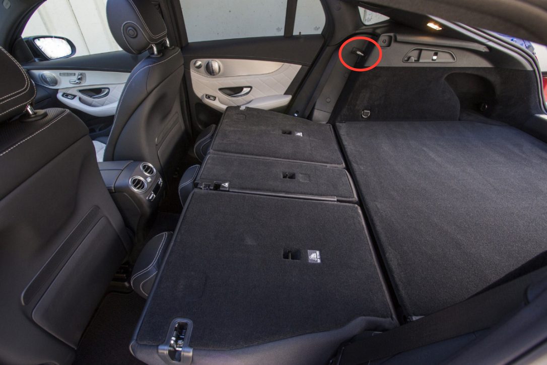

Which part of the rear bench is this? I don't remember seeing this latch when i fold down my rear seat backs.
My latch is those that have 2 configuration: 1) when down, the seat backing will be in normal recline angle 2) when up, the seat backing will be more upright, freeing up abit more cargo space.
here you go. a picture from google shows a coupe but the latch is in the same position.

Thank you!!!!! I was ready to trade off my GLC43 because it sounded like it was going to break in half at slow speeds. I thought it was the sunroof and so did my husband. I decided to try your suggestion and I immediately knew you were right! Unused duct tape on those 2 rear seat brackets and it solved it! You just saved me $70k for a new car!! I can’t thank you enough for your post and for the photos as I copied what you did.
