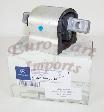

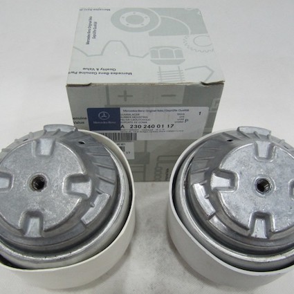

Your car is 2008...left only 1 years to drive...no need buy original parts, OEM will do.
OEM Gearbox Mounting = $25
OEM Engine Mounting Left & Right = $50+$50

Hi sorry for reviving this thread up but have just solved the exact issue with my E230 W211 2008 car. Now loving it. Quiet as a church mouse now. Went to my regular JB garage but seems I paid more than what iMac was charged...boo hoo by about $100 more. But then, Instead of OEM, my mechanic got for me a German brand ( I saw the brand on the box starting with G....) Said it will last longer than the OEM ones. Took his words for it. RGT $1,200(SGD400) for the 3 said mountings. Overall happy like shit because it solved my problem, exactly like Jimmy's. I also changed the Transmission oil and transmission filter. I guess that does the trick. I too have renewed my COE in June this year.
