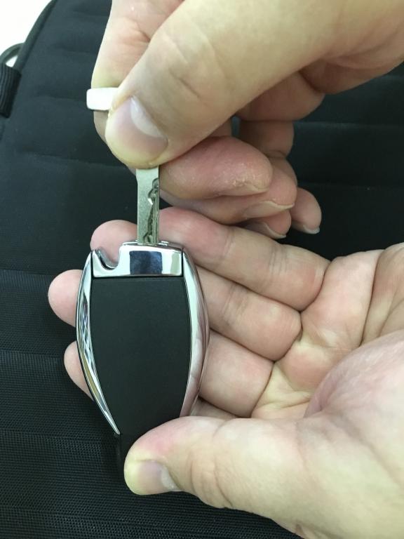

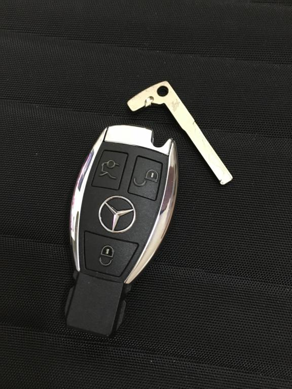

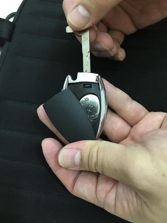

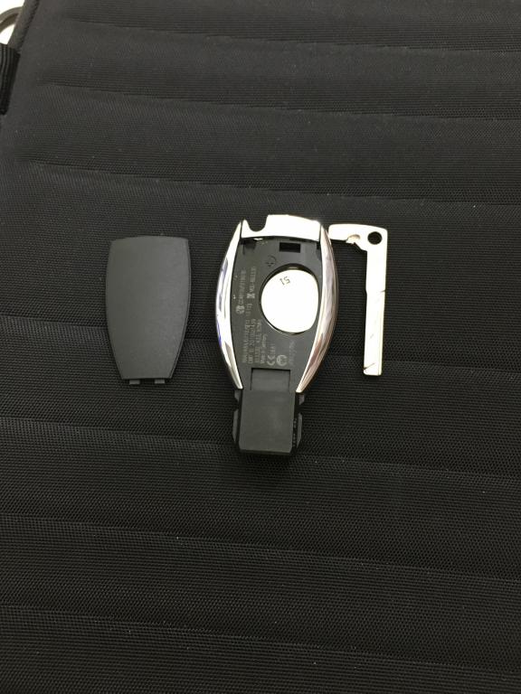

For those with the newer transponder - This is a 2 lithium coin cells CR2025
This Lithium CR 2025 coin cells are available at local supermarket counters especially NTUC @ abt $2+ per cell.
If your current cells in your transponder is below 3V DC, it's time to change the cells.
A fresh cell should have a voltage of abt 3.2V DC
Do not put the cell on a metal surface in case U might short circuit the cell.
Change transponder cells on a non-metal surface eg a wooden table top, a glass top, etc.,

Here's a video to show you how to change the battery on your MB Transponder.
You will need to replace the 2 Lithium Coin batteries - CR2025 inside the transponder.
You can buy these CR2025 Lithium Coin batteries at any NTUC or other Supermart!
