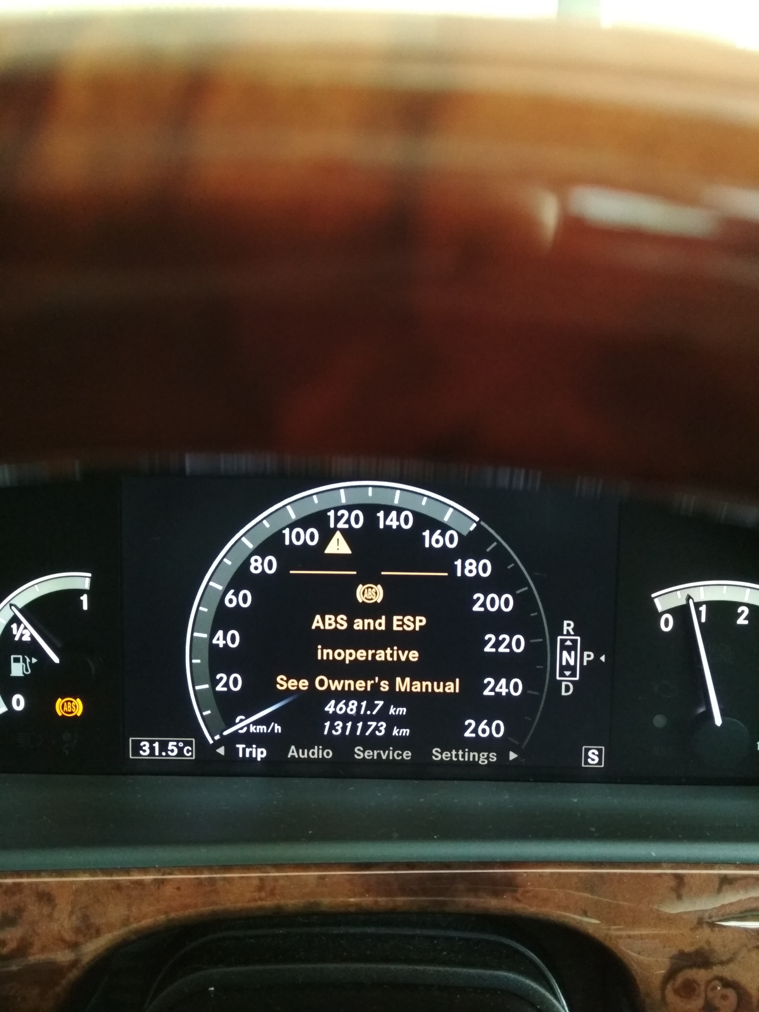

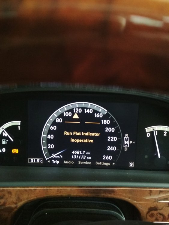

 I just did my regular pump-up tyre air pressure. Not long after drove off, the dashboard 'ABS' symbol lighted RED and error messages - 'ABS and ESP Inoperative. Run flat indicator inoperative'.  I lost steering power . I start/stop but error message continue to exist. Fortunately, I drove slowly home (20-30kph).
Would like to seek advice/comment whether this could be a DIY remediation or have to send to workshop (any recommendation)

Thanks...went to CNC and confirmed ABS hydraulic pump cum module faulty. Quote is very high. Plan to seek cheaper solution from other workshop as 10 mths to scrap. I welcome any cheap solution/suggestion
 Currently can temporary drive, keep below 90kmh and avoid hard braking....major inconvenience is heavy steering during cornering.

Hi dchum, thanks for your feedback. I have found a WS that provides pre-owned ABS /ESP hydraulic pump+module+reprogramming on a no-cure-no-pay basis. The price is down to earth as compared to CNC (through a new unit).  I will provide commentary once had it installed/tested next 1-2 day

Hi All, I am happy to report that today I have successfully replaced the faulty ABS pump+module with a pre-owned unit from a WS in kaki bukit. The young, honest and friendly mechanic did an excellent job in the complex programming for a total 3-figure amount, with 1 month warranty return on the item. It's only 25% of CNC quoted price, albeit a pre-owned unit...hope it could survive 10 months.
