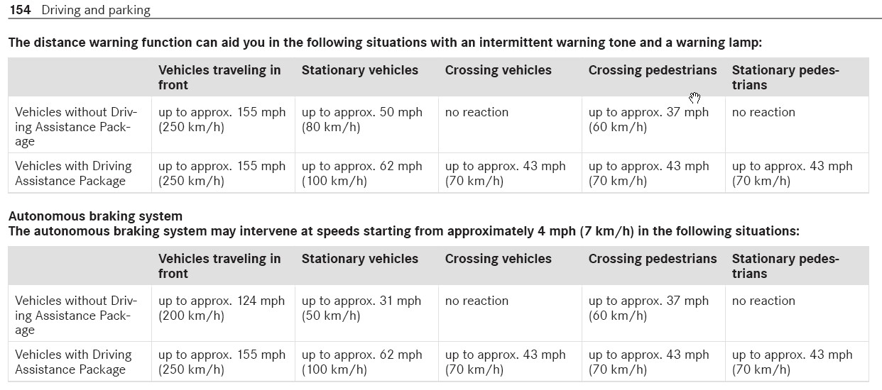

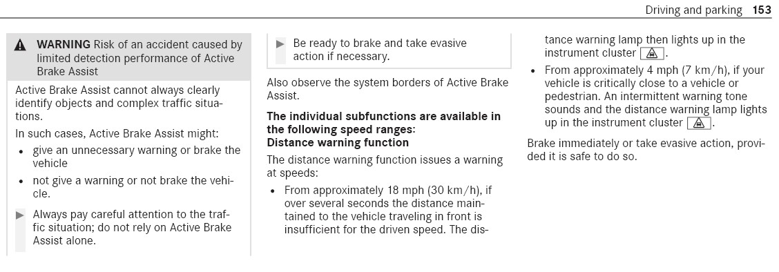

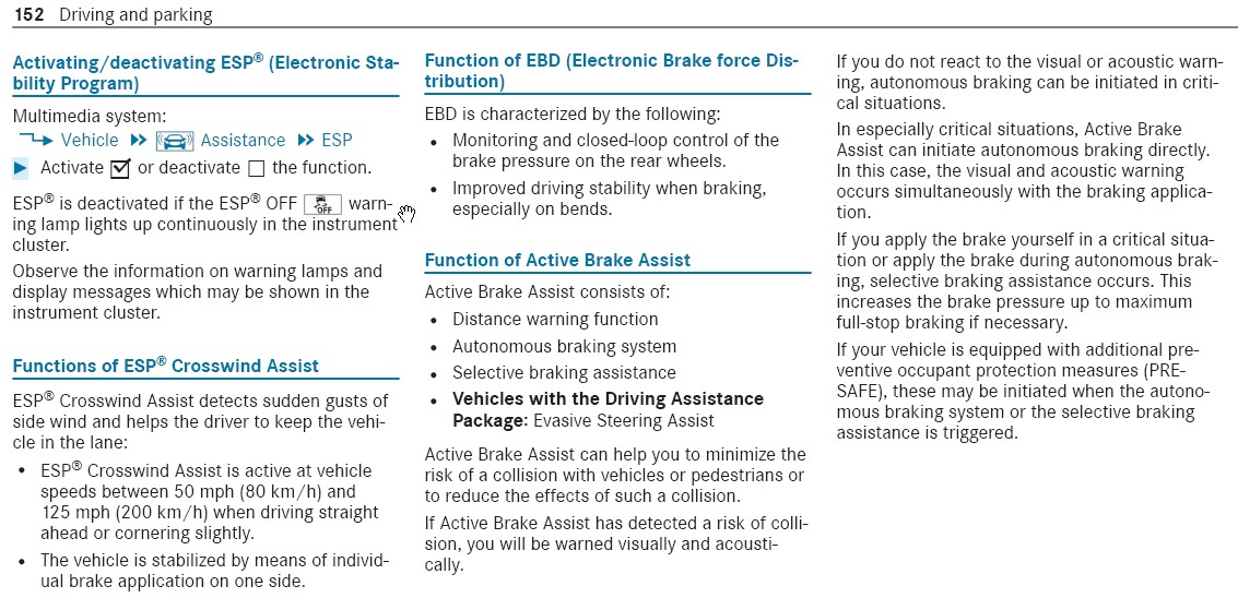

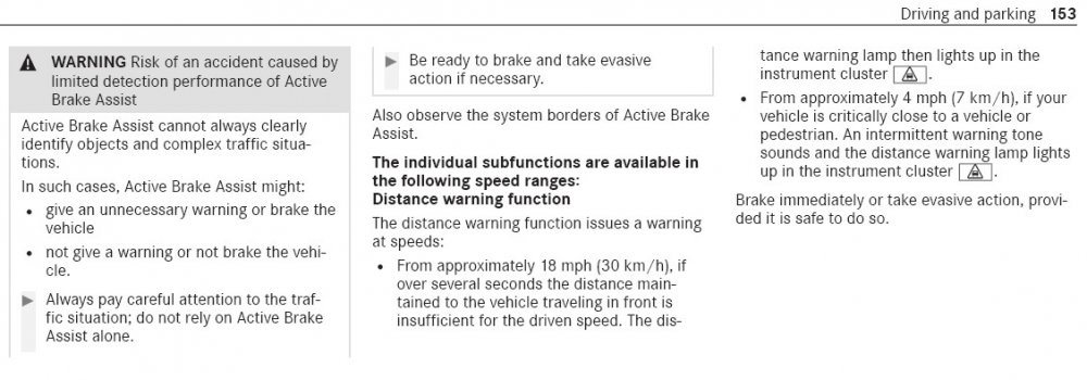

The W213 Active Brake Assist have 2 function, first is audible warning signal to warn you if you are too close to front vehicle and 2nd is Auto Braking will be activated if audible warning is ignored.
The audible warning sound may be quite irritating for those who use to keep close distance to front traveling vehicle and also if audible warning are ignored it may auto trigger the Active Brake Assist.

Thanks for the effort jmt510, would you share a bit of your own experience? Do you turn it off when you drive? And did it actually work and make any difference?
Thanks again.
The Active Brake Assist is a 2 sided blade... When you are driving on the Expressway it will give a warning sign that you are too close to the front car and you will anticipate it and slow down. Whether the car will slow down slowly or will brake in time will be anyone guess for now...
Overall I find the Active Brake Assist quite a useful function overall in terms of giving us a clear calculated speed warning that we are too close. Cheers for keeping the road safer.
