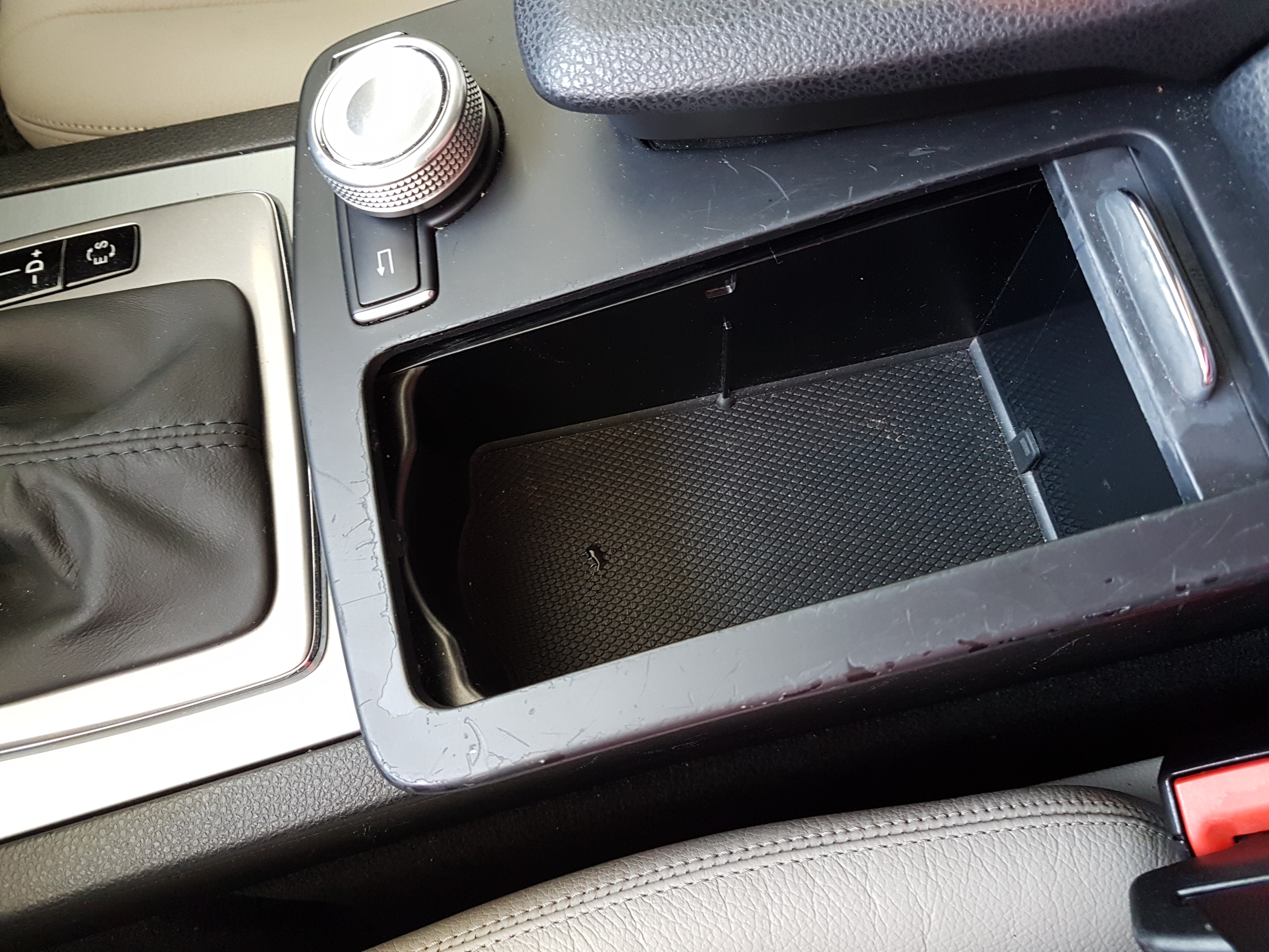

Anyone knows if this part can be replaced?

Can buy from Goldenlink. I have changed it before....DIY. Need a flower-shaped screw driver ( available in hardware store) to remove a screw below the small rectangular tray after opening the arm rest. While you are at it, might as well buy the rubber sliding cover at the same time & change them together.
