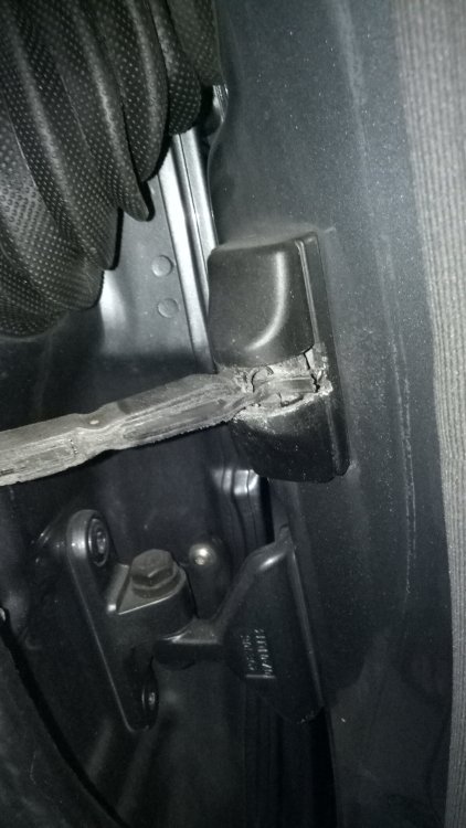

Hi,
Anyone got this part replaced before?
Mine just got broken when my daughter open the rear passenger side door as we got home this afternoon. See attached photo. Seems plasticky and quite fragile after the years of opening/closing. Door unable to hold it's position once broken.
Googled just now and seems this is quite an easy item to replace. Just need to get the part. Will attempt self DIY next week or so when buy the part. Made a PDF for sharing. (content extracted from mercedesmedic webpage)
Appreciate if any bro here could share the relevant experience.
Thanks
Emailing W211 door strap check replacement.pdf
