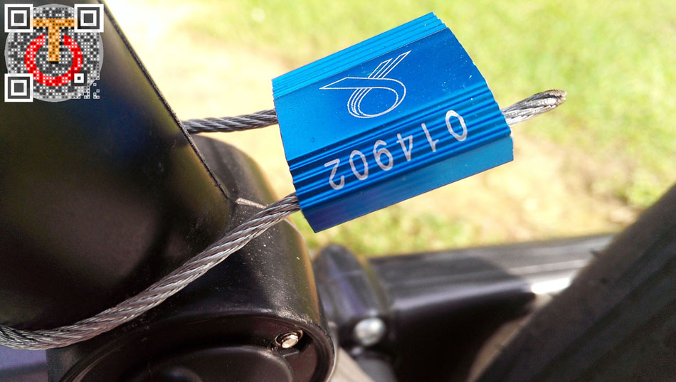

*Install LTA Serial-Numbered SEAL (look like some metal cable-tie, see picture attached)
