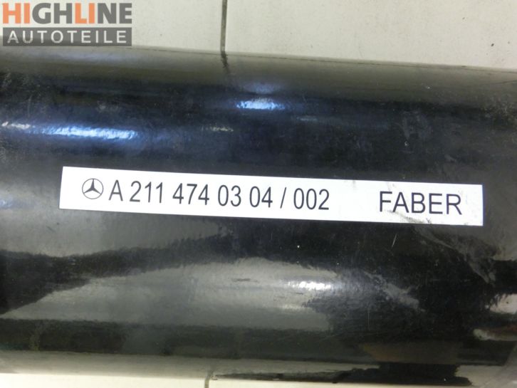

You should be looking for a pair of these...
http://hl24.eu/wrn.php?daten=390450&lc=HM&suchb=alle_anzeigen
2006 W211 MERCEDES E200NGT
No luck here too . Tried to ask LTA for alternative but no go. Saw a Munich Alpina selling a 06 ngt.... can high speed motors talk to them and borrow the full set of tanks for us to do a disable of the system. Or anyone in this forum ?
