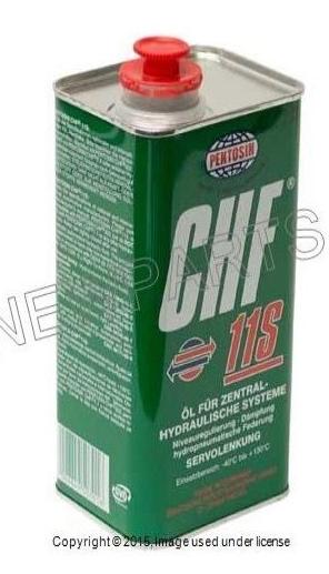

OK, its now clear. Must use the syn fluid with Pentosin CHF11s (FUCHS).
Also call Tye Soon, they said its new packing. Its Synthetic. Oil colour also different from earlier lot. (previous - Green colour / new - yellow colour).
Learned some thing. Phew.
*never just listen to old mechanic tales (ATF is = power steering). Seems they are not anymore !

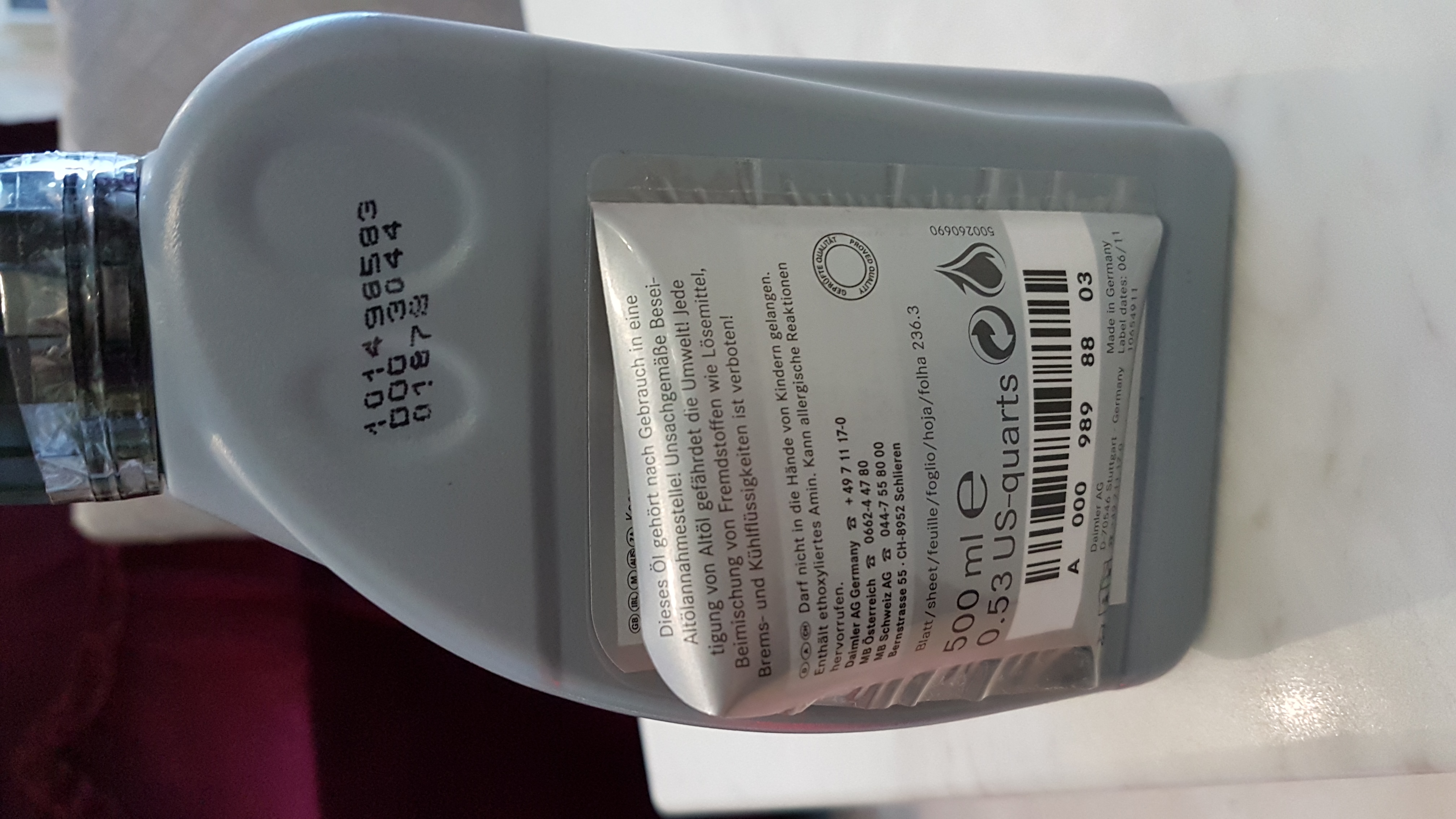

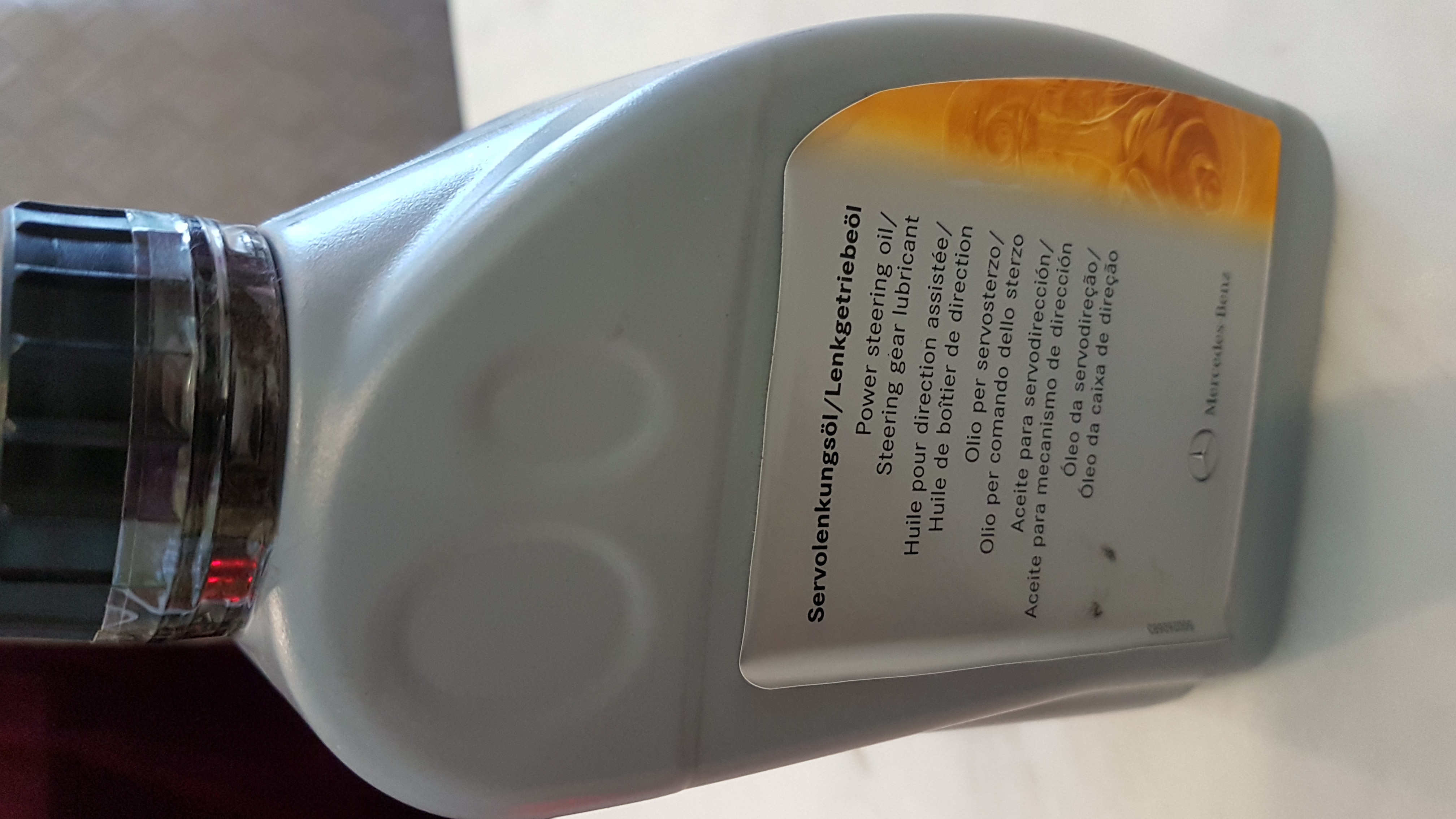

My power steering giving grinding noise over past few days during cold start up. i reckon its time to top up power steering fluid n so went to Tye Soon this morning to buy the same one as bro Tanwill did.
However, after payment and when I collect it, I read on bottle that it is following MB sheet 236 3 ???
From earlier post, I always thought the correct one would be MB sheet 345 ??? Synthetic type (Pentosin CHF 11S)?? Now again is different?
Did a search somewhere in mbworld or benzworld forum and realize for Mercedes Benz model that :
a) Power steering pump using engine serpentine belt drive die die have to use MB sheet 236.3 specified power steering fluid.
B)  Power steering that is driven via electro-Hydraulic setup will have to use MB sheet 345 specified power steering fluid.
So, may I confirm our facelift W211 is (a) or (b)? My engineer instinct is telling me (a).
Mine is E230 and shouldn't be different from other W211 models. I can also confirm power steering pump is driven by the main engine belt alongside with radiator fan & aircon compressor.
Lol. KNN now i know no wonder it is so confusing...Lol
Better make sure before I start pouring it into my power steering pump reservoir. Haha
So it is quite certain MB Sheet 236.3 is the correct P.S. fluid.
But then again when you look up Bevo for MB sheet 345,
http://bevo.mercedes-benz.com/bevolistenmain.php?navigation_path=bevolisten&language_id=1&blatt=345.0&content_action=show&mark=hydraulic&suchbegriff=hydraulic
Model 211 is quoted ok wor ??
So KNN, which is the correct one ???

Bro,
Best to check back with C&C.
W211 has many model...including CDI with might be using different type of power steering motor. (the video above is E280-CDI)
One of the different between both type of fluid is the thickness.
2006 W211 MERCEDES E200NGT
Thanks bro iMac,
Didn't bother to call C&C. Car past 10years now and don't suppose they will entertain you anymore.
Anyway. I already pour 2 tablespoon this morning. Haha.
And viola!, immediately no more noise. But jin wasted.
One big bottle of about 480ml still left.
Sealed up with tape and wrap over vacumm seal  bag.
Any bro need, pls PM me ok?
