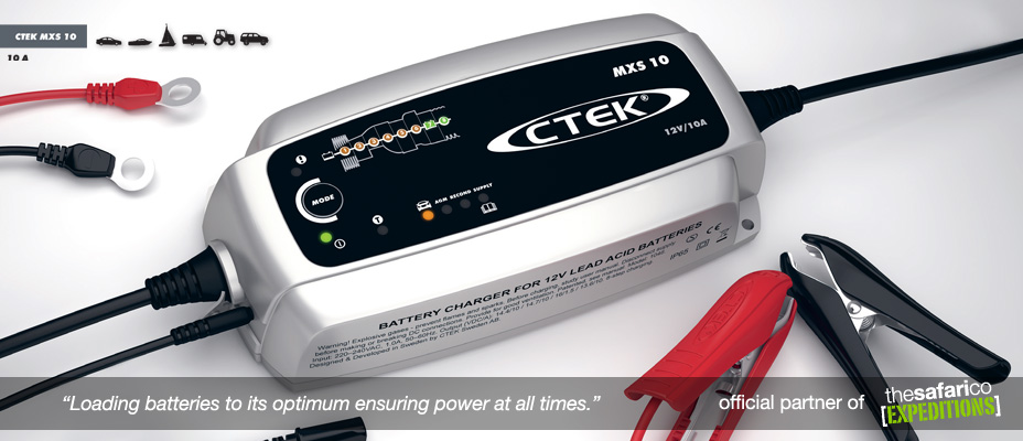

I had the same issue of car batt dying prematurely.....even with AGM battery. And I even disabled the parking mode for the dash cam. My short distance to work, 3 cars to alternate with & frequent travels can actually kill the batt. The car needs to be used more to charge up the batt while on the move. Well bros, I have found a simple solution to prolong batt life, BUT you will a power socket.
Introducing the trickle charger....specifically CTEK batt charger. This CTEK is recommended & sold by Merc AMG, Ferrarri, Lambo & Porsche, though they are rebadged. I hook it up to my car whenever I travel or when I find my batt low (thru a Bluetooth app that links to CTEK batt sensor).  It's available at Lim Battery for $180 I think.  Once hooked up, you can leave it charged for days, weeks & months and the trickle charger will maintain & recondition the battery.
Yes...this is the batt sense (sensor) that I was talking about. It's very convenient to use  with Bluetooth.
I had it free when I bought my CTEK batt charger....came in a bundle during a promotion with Lim Battery.
