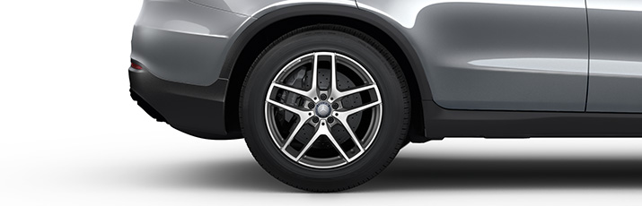

1 hour ago, Benson said:
Just wondering is there a diff btwn AMG vs non-AMG line for that annoying issue?
AMG Line has different rotors that are cross drilled ventilated. The brake calipers are different in size and shape. The AMG Line calipers have "Mercedes Benz" letterings printed.
I suspect there might be a difference in piston numbers or size.
The brake pads likely to be different as well.
So far feedback seem to suggest that those with AMG Line brakes seem to have escaped the dreaded reverse screech.
Therefore I am asking to to get and idea.
resized-20160422150343402.jpg.022c31390c591875dc8514703b1df3a8.jpg20160908_175032.thumb.jpg.52f55b703996ce98d8caeb5caab1ba3d.jpg
mercedes-benz-glc-class_x253_638_48992_5doublespoke_19inch_detail_715x230_07-2015.jpg
4 minutes ago, Benson said:
I see... Ya yr assumption does make sense.... but I read online the GLC43 come with AMG as standard also encounter such issue. If really AMG brake kit can solve the issue then those bought from CnC ones shld change the entire brake kit to AMG FOC!! 😤
Overseas forum also reflected that changing to new compound brake pads worked but seem like at least a few of our local guys are not as fortunate despite going through a few brake pad change.
I am guessing that the brake pad material glazed over when heated causing the screech when applied to the smooth rotor surface. For the cars with cross drilled rotors, the holes on rotors might scrape the glazed surface to break them up resulting in less screeching?
I do get alot of brake dust in exchange though.
