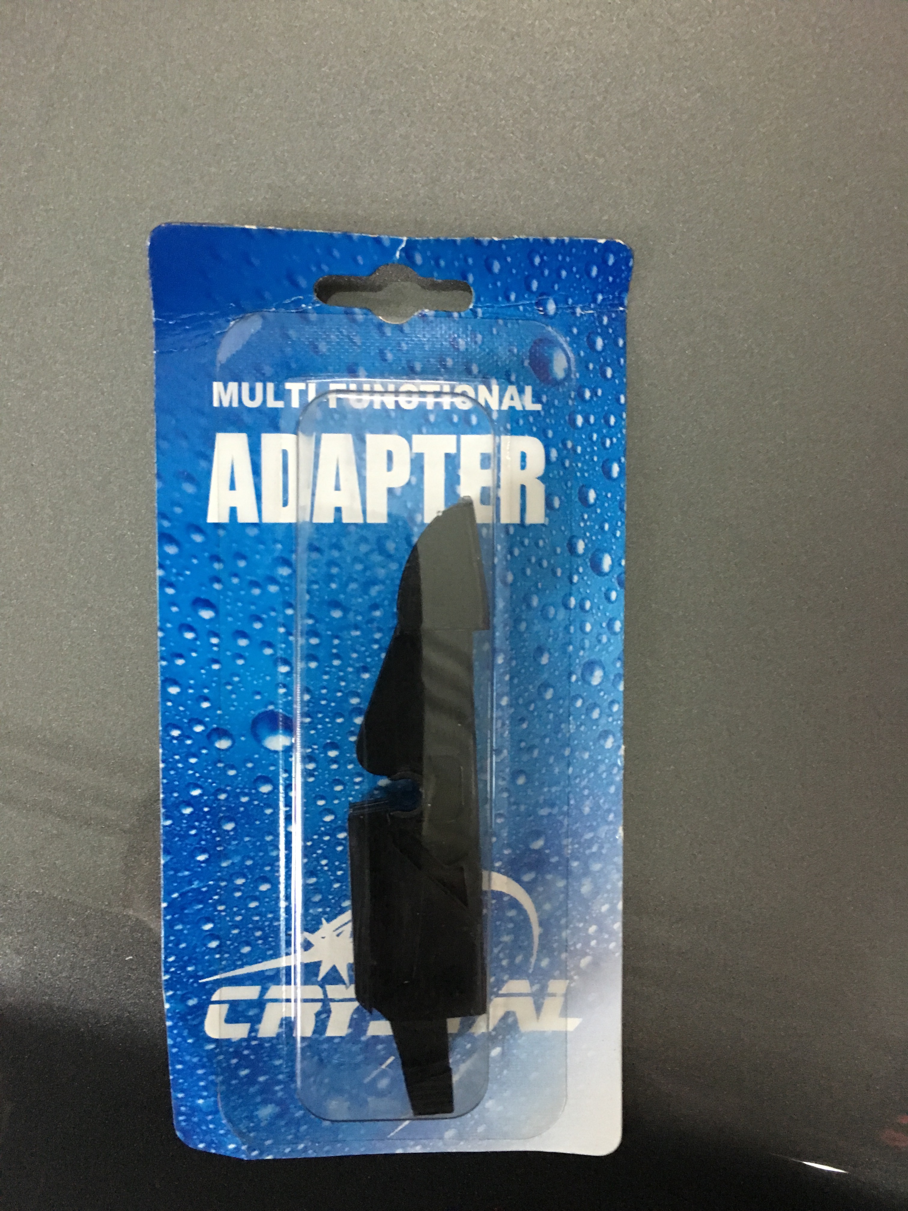

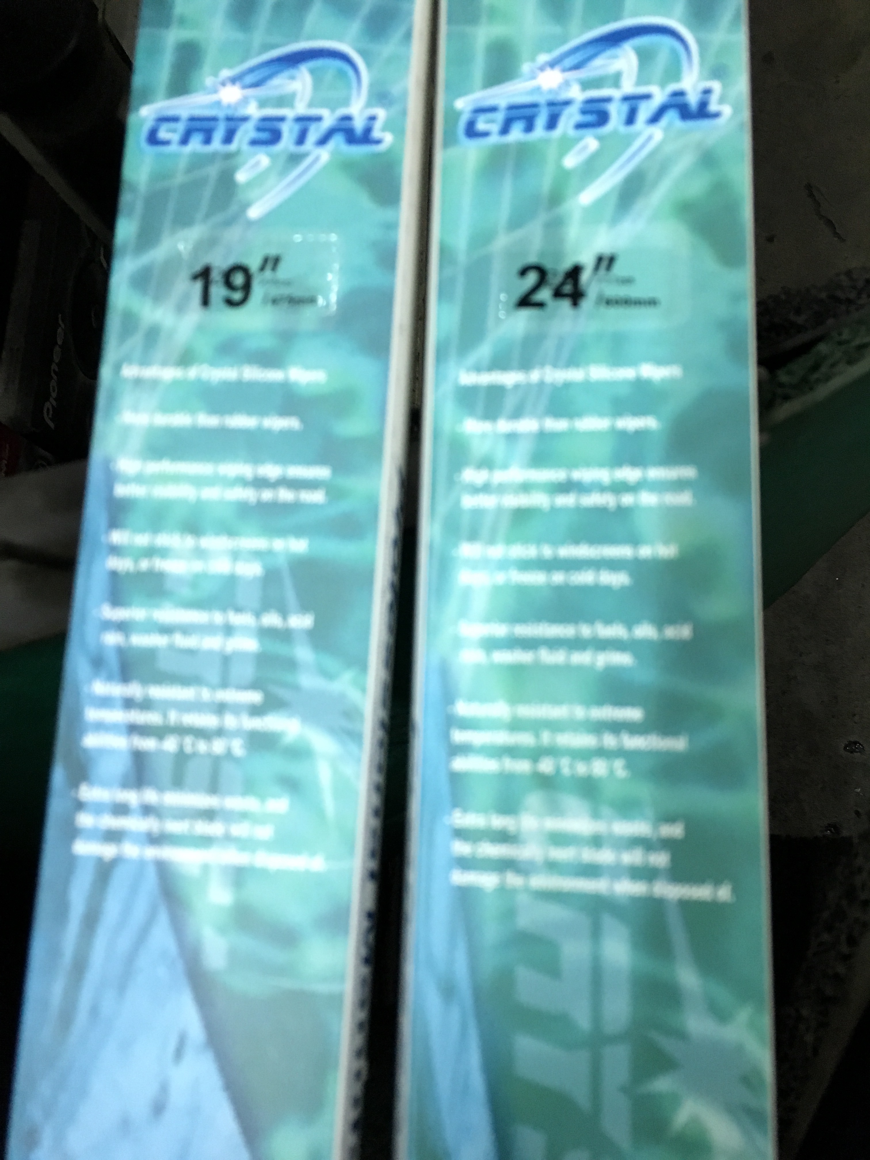

Try this silicone wipers called Crystal Wipers. Apparently not many silicone wipers are made for Merc ....PIAA makes very good silicone wipers but only for W204 & it's very expensive. Found Crystal Silicone Wipers after a long quest for my CLA45....not the best, but at least it got rid of the juddering & it's inexpensive. There are many adaptors available to fit them
