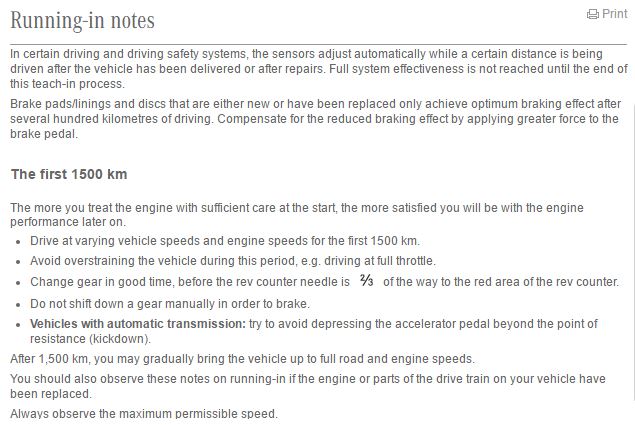

How long it takes to bed in? Actually the sound is not there when braking at hi speed. Only hears it when it moving slowly and stopping...etc. in a jam. I booked a appt on 26th to let them see as busy this week with lots of meeting. Also need them to look at my rear bumper too. Seems not aligned properly. Can see gap diff.
