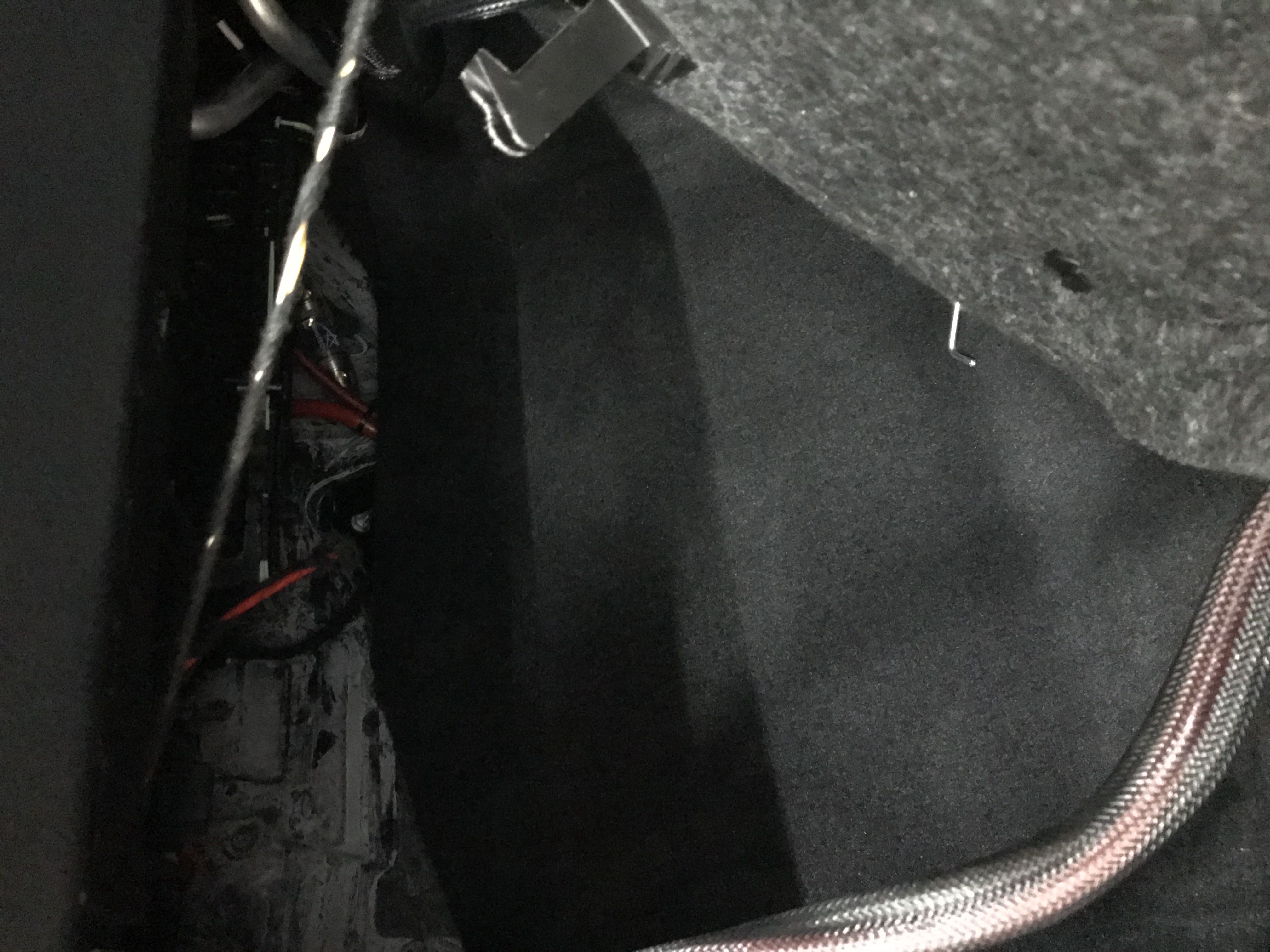

looks something like this...

I got my W212 auxiliary battery replaced for $180. The battery is located at the trunk.
