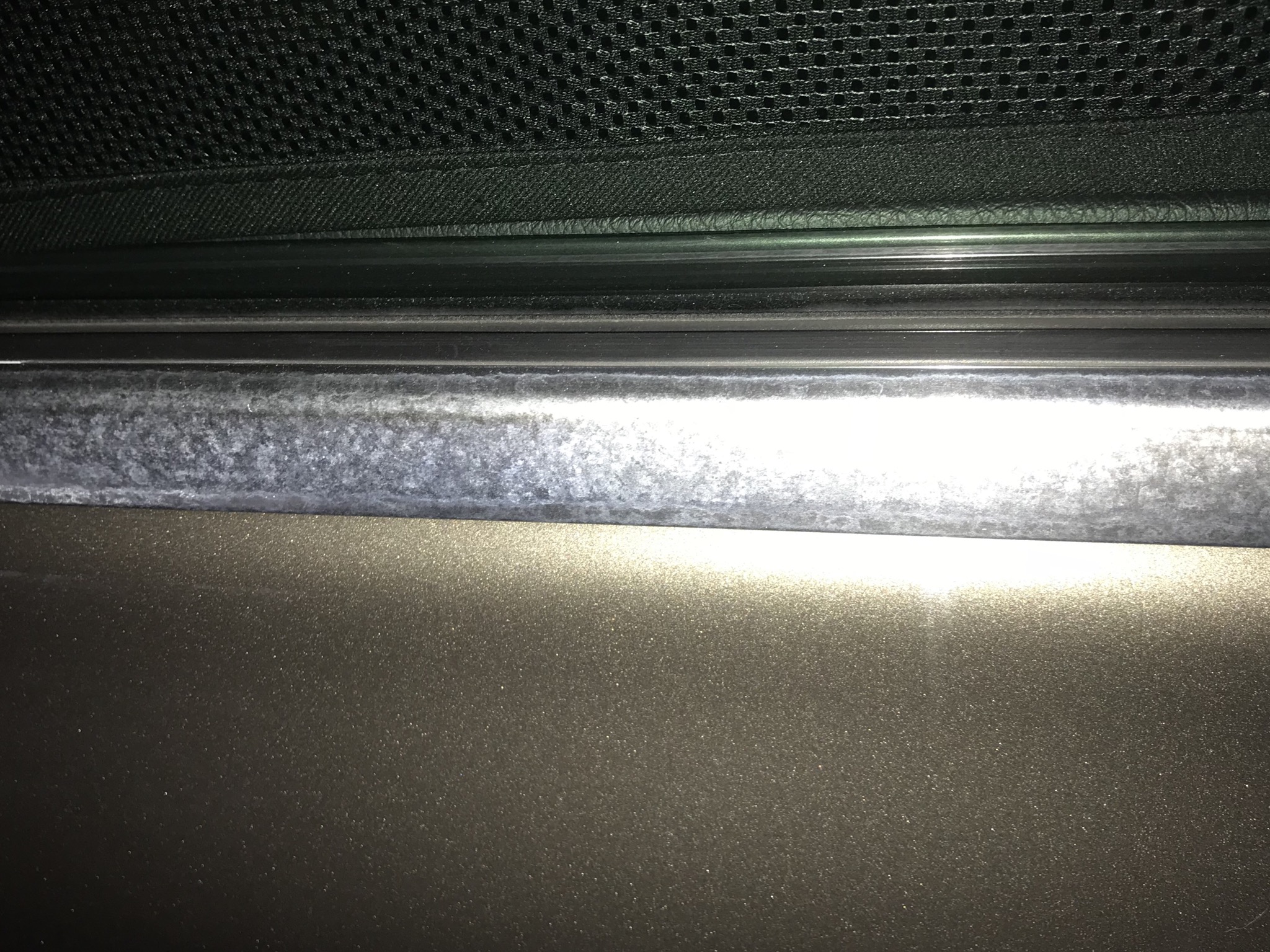

Hi Guys
i am a new owner. I got the problem with the chrome window trim. Is tarnished. Tried autosol and turtle metal polish..both doesn’t work. Any other solution ? Help needd

Hi
as attached, I tried autosol, brasso, and tooth paste and turtle polish
nothing works
please please help
4 hours ago, Simonlim said:
Hi
nothing works
please please help
Gee ! That looks like a de-chrome surface.
(you sure its chrome before the polish ? or its a black strip ?)
7 hours ago, Simonlim said:
Hi
nothing works
please please help
wow, looks bad :(

Hi
i tried all the above
Still the same
very sad for me
