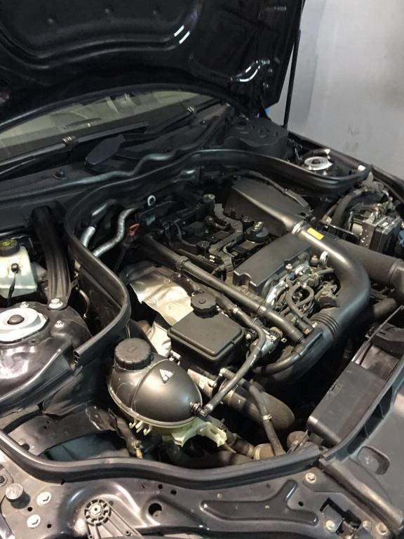

Just took over a 2012 W212 E200CGI.
As the previous guy didn't went back to C&C servicing. So i did my major servicing to play safe.
I did the following replacement parts after taking over. All parts taken from stocklist.

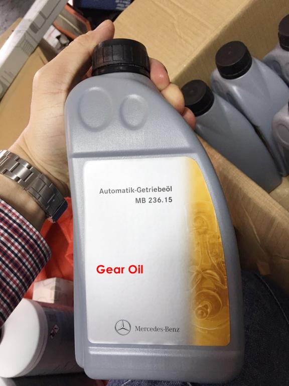

Original Merc Gear Oil X 10.                $160

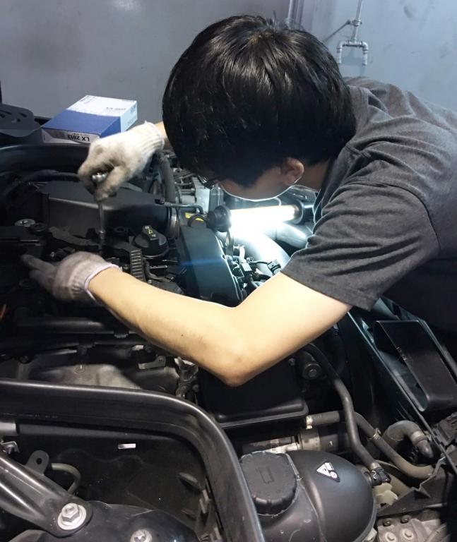

My mechanic starting to dismantle...

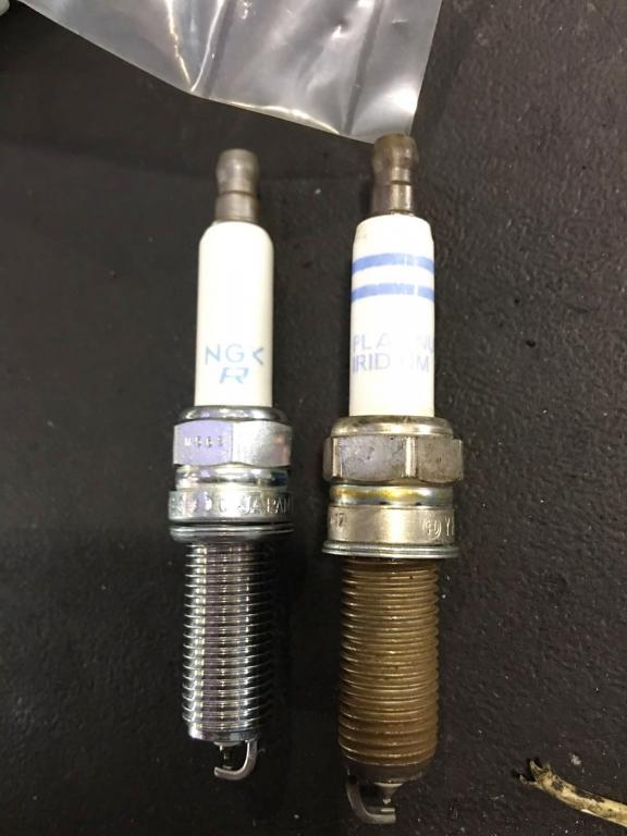

New plugs Vs Old plugs

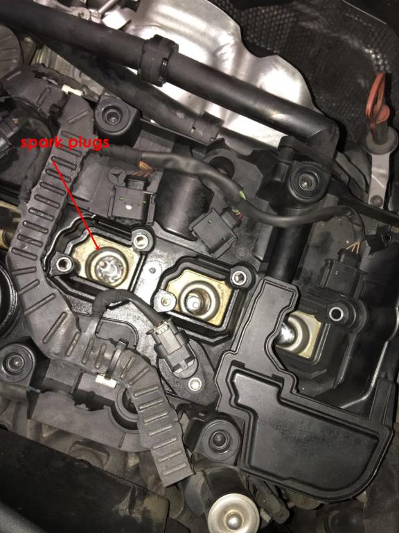

Replacing with new plugs

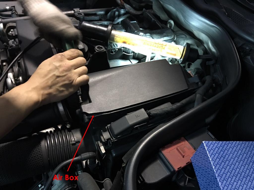

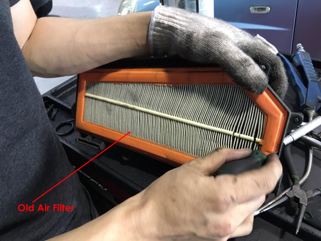

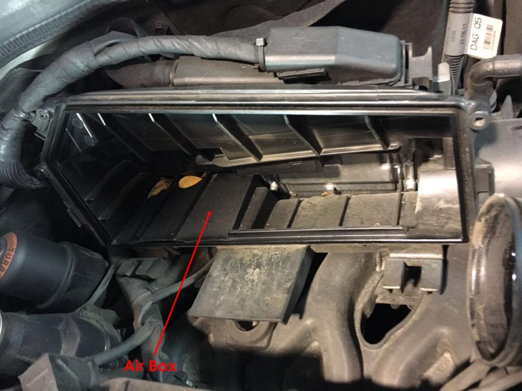

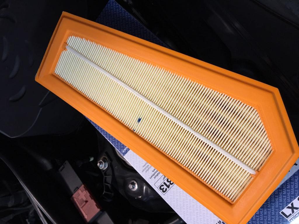

Air Box
Old Air Filter
New Air Filter
See how dirty the air box is?

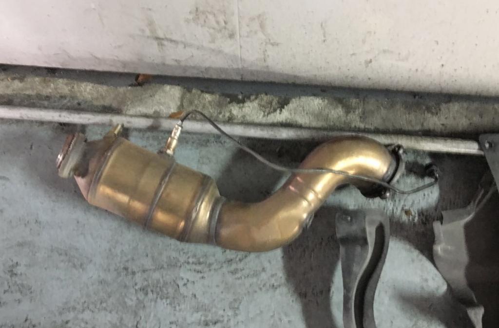

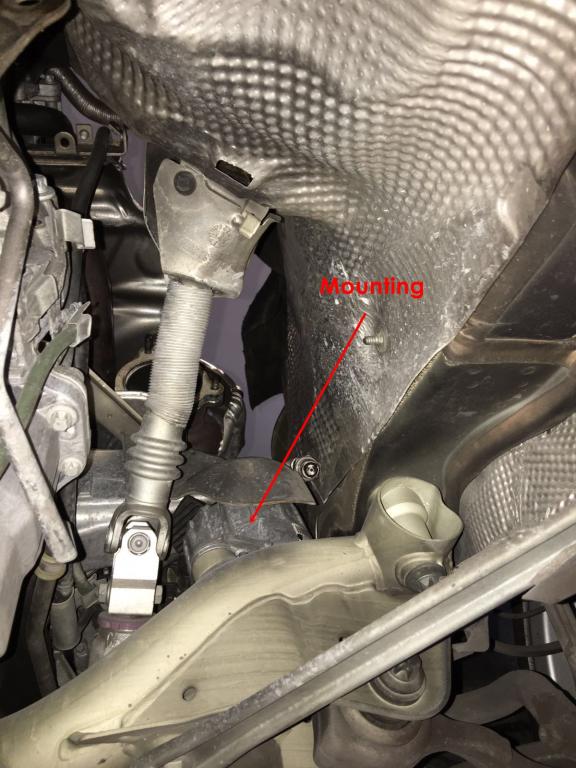

Need to remove one of the cat to access to the engine mounting...
Mounting at the right...

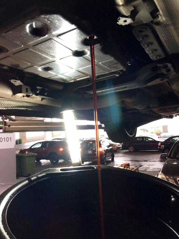

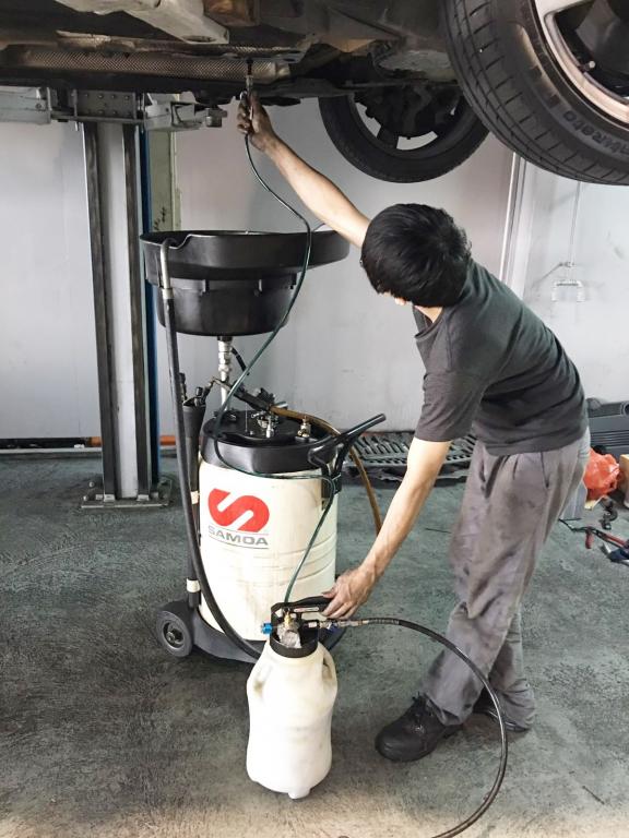

Engine needs fresh oil. I used 1 new 4 litre turtle oil to flush my engine & away the old oil before i put the new mobil oil in.

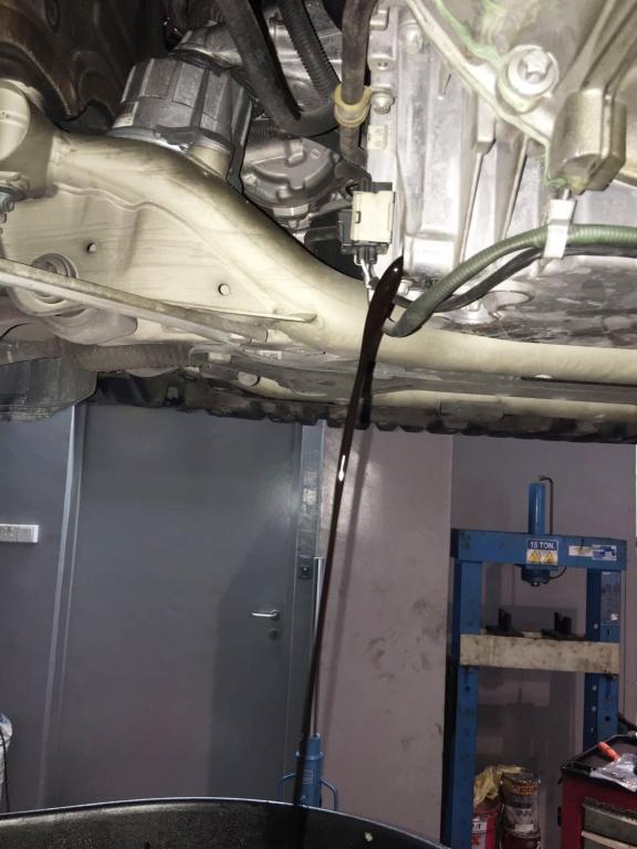

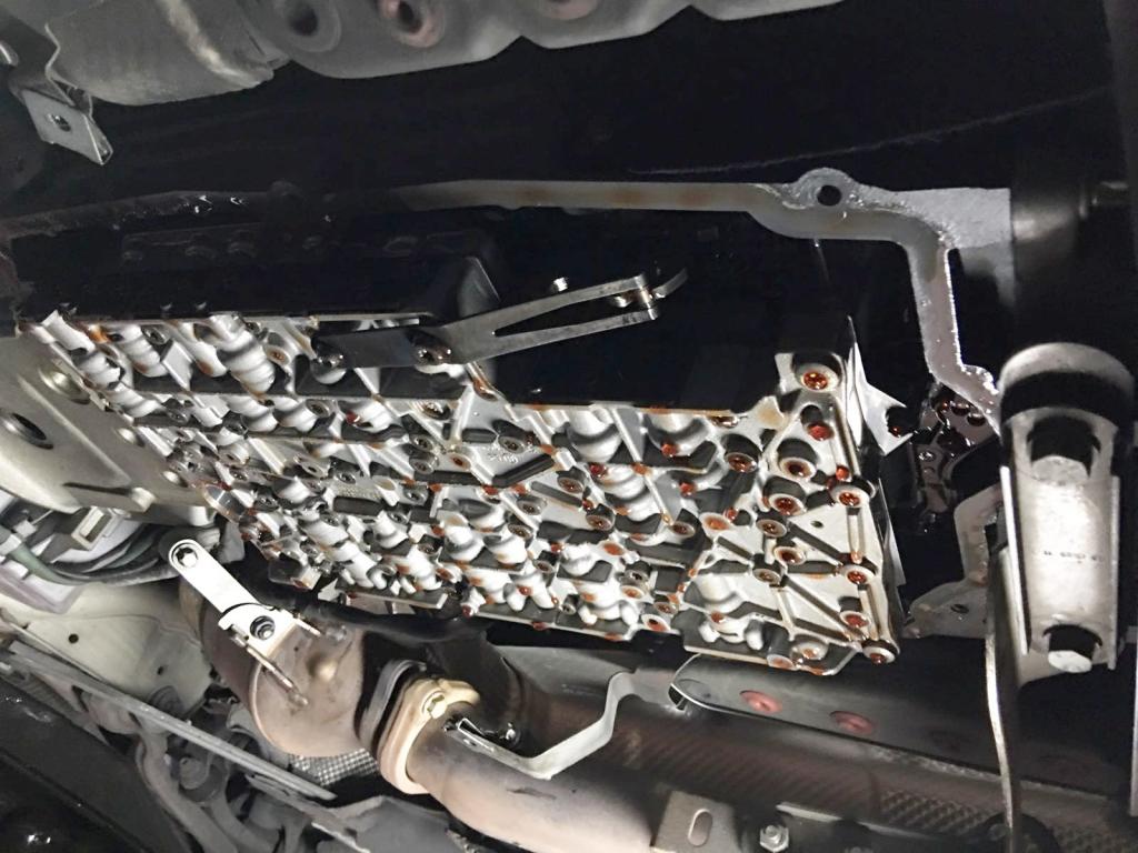

Drain away the old gear oil.

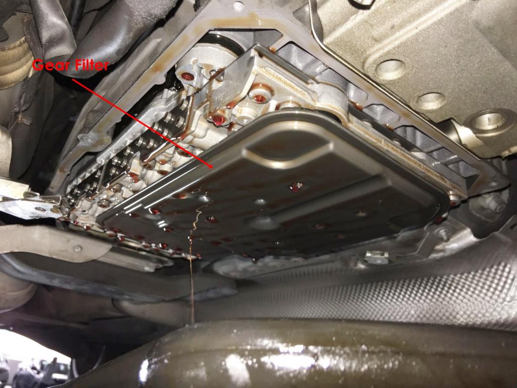

Gear Box with old gear filter
Gear box without filter

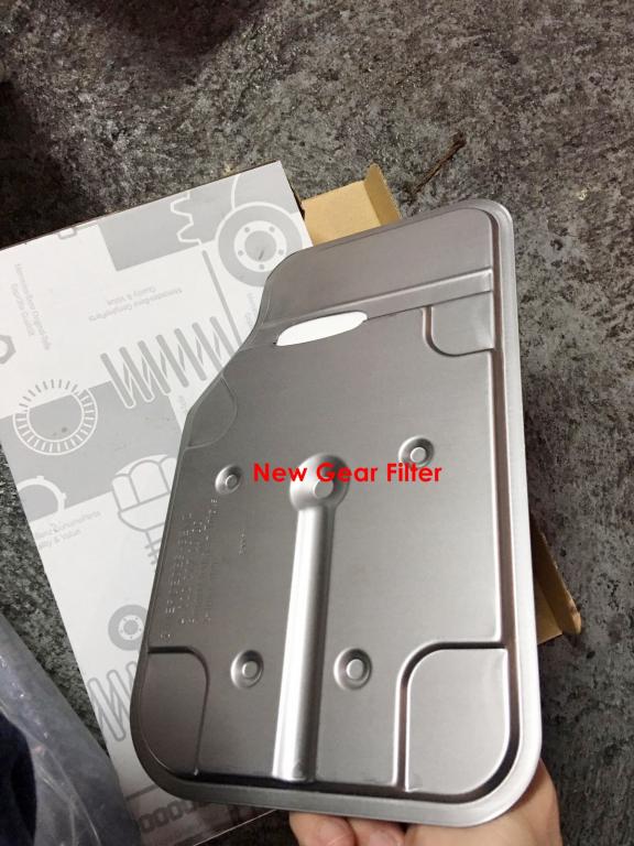

New Gear Filter

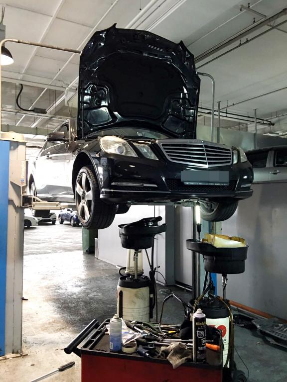

Car hoist up
New Gear oil
Gear oil must put into their pump to pump back into the gear box

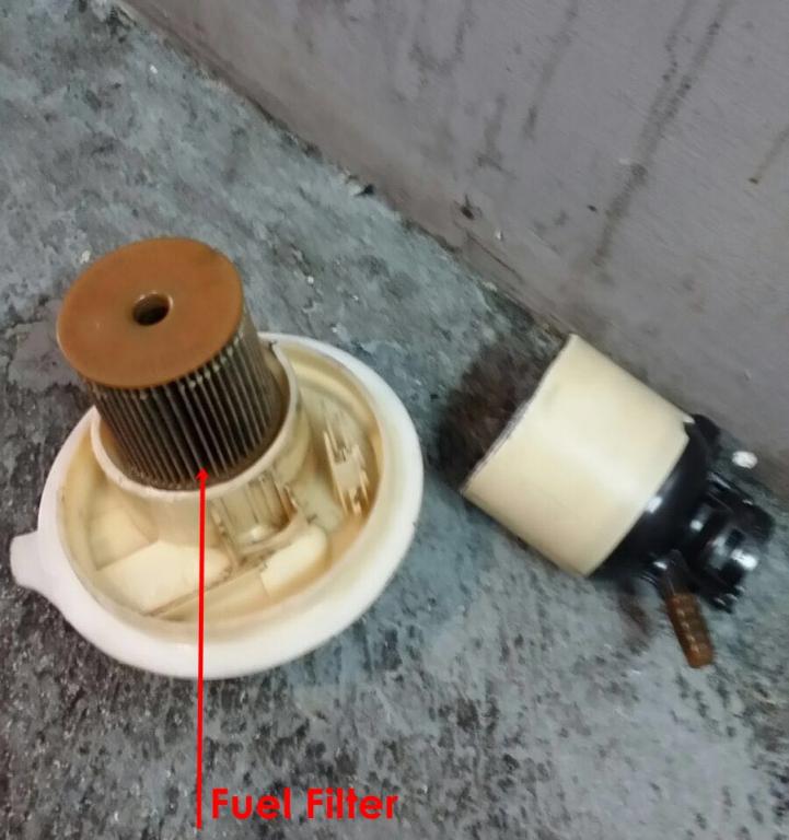

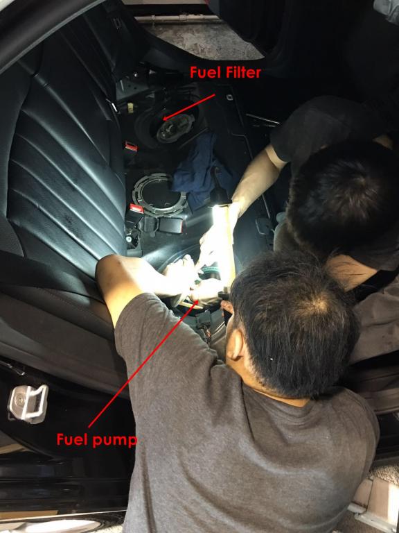

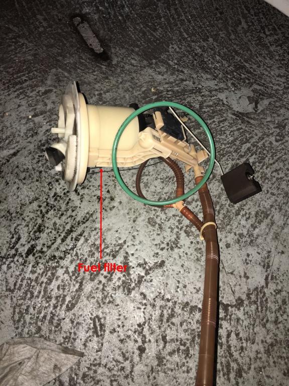

Taking out the Fuel pump & fuel filter. Then can replace with new fuel filter.
Old Fuel filter
I ask my mechanic to saw off the fuel filter to see how does it look inside.
Now this is how it looks like after traveling 100k! See how dirty it gets?
