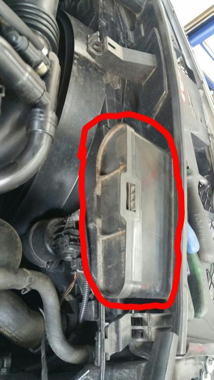

Does anybody know there is a 2nd air intake from the grill ?
Do i leave the cover there or remove it for better air flow inside engine bay ?
Heard that it is meant for V6 engine air intake
Thanks a lot
Yes. It's meant for "V" engines, V6, V8. I assumed MB did enough R&D and for whatever reason, their engineers choose to cover the unused side. Why mess with it? Removing it doesn't improve anything.

I strongly recommend that the cover of the 2nd intake be removed for better cooling of the turbo which lies in front of it.
My CLA45 came with the 2nd opening opened by factory for the same reason even though there's no provision for V6 or V8 engines for CLA range.

Huh? The opened vent does not lead to the air filter box...it merely direct air to the turbo for cooling. But there's some dust & a bit of rain water do get in to the engine compartment.

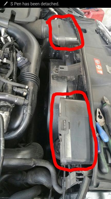

Does the air intake supply air to both vents such that in the event the 2nd vent is closed, all the airflow goes to the 1st vent?
If we remove the cover for the 2nd vent, would it result in lower airflow to the 1st vent since air can now "escape" from the opened 2nd vent?
Nope....no effect whatsoever to the 1st air intake.

Thanks, bro Jtang! I just took the cover out for my kompressor model! Hopefully work as well as turbo models!!!
Lol, just do it for fun lah!!! No effect then place back the cover
Don't mean to dampen your enthusiasm & definitely not making u out to be a Merc engineer wannabe, this thread was about turbo cars (i.e. CGI cars). I don't think it applies to kompressor models becos there's no turbo to cool. The supercharger does not heat up like a turbo because it's mechanically driven. But hey, if you are happy doing this....& can mentally picture an increase of 2-3bhp, why not?
