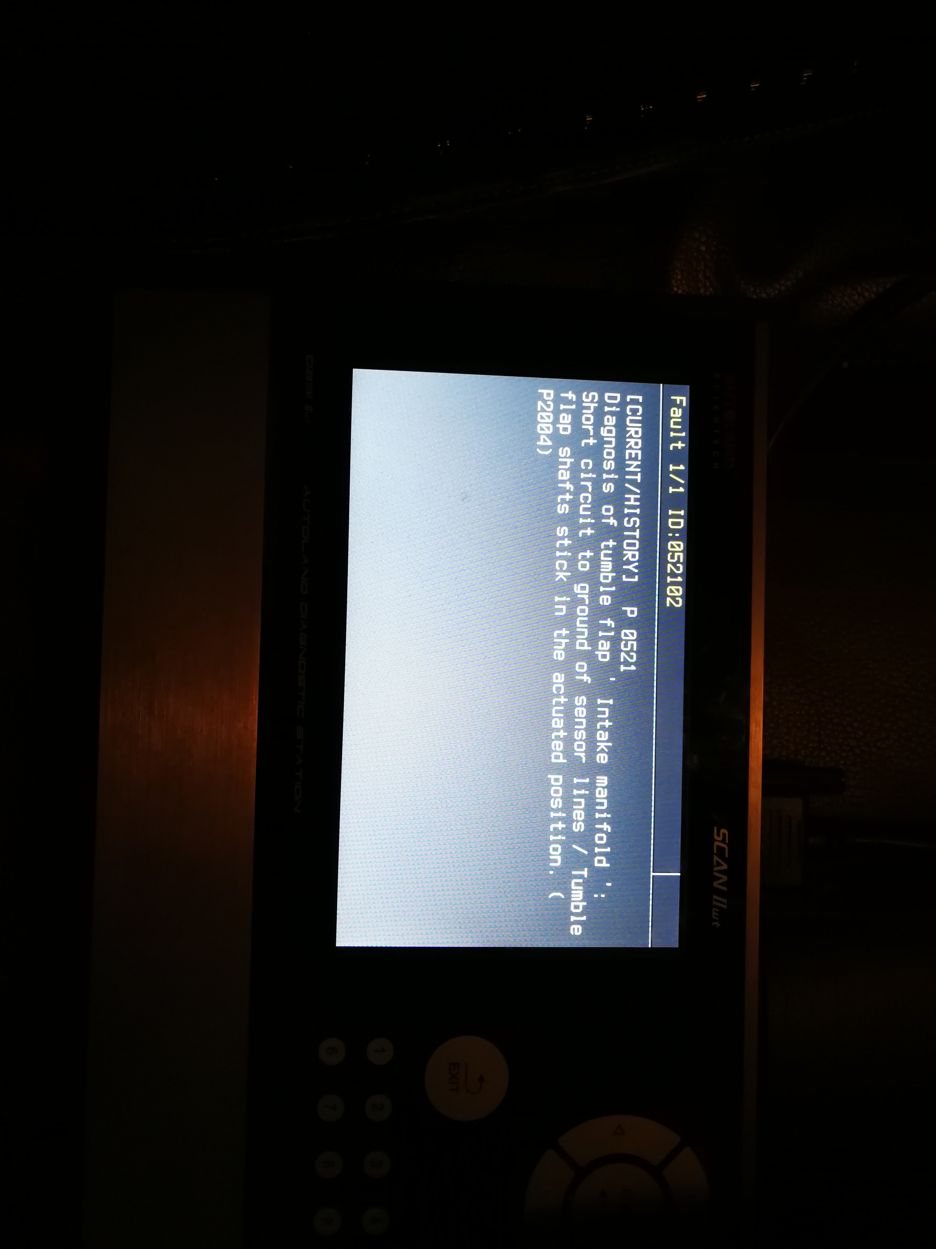

Actually my obd scanner didn't throw a code for the intake manifold. Only my workshop computer can pick it up.
The obd scanner saw a code for the transmission. Code points to a faulty high-pressure solenoid G or something like that.

I'm very interested to know the answer to this as well. My intake manifold has been broken since I took over this car years ago and I never bothered fixing. But may consider fixing on my next ride if it makes economical sense.
pick up is sluggish with broken manifold. Will be able to detected in diagnostic test, depending on how good is your diagnostic tool.
I won't suggest buying a basic diagnostic tool. Spend a bit more to get a detailed one.
I got a Icarsoft MBII tool for about $300. This diagnosis details is almost on par with original mercs diagnostic software used by most workshop. Important to have one especially if you travel to Malaysia. Allows you to temporary clear faults and continue driving until you reach back SG workshop
I just replaced my intake manifold with an oem unit. I will have the say the car is noticeably more powerful from standstill and at lower rpm (which is most of the time the rpm which I drive at)
Because of the higher power I feel that i give less throttle input when requiring to accelerate or climb uphill. I'm looking at about 10L/100km consumption now. Down from 11.5-12L/100km
I think it's worth it. Almost like a power upgrade.
