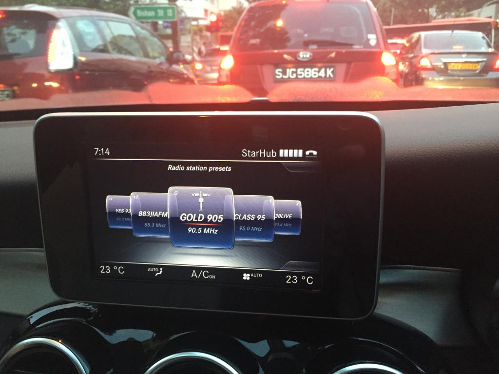

Hi Guys,
The aircon on Auto and even manual setting causes my windscreen to gets fog out.. This is irritating as I need to activate the wiper.

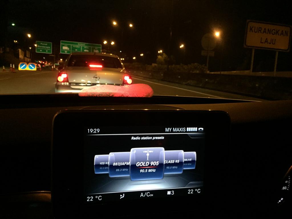

Hi Markcwq,
Have done that and the difference is the misting will appear in the centre. See image.

Hi pearl jam ,
Thanks for your suggestion. I have tried to direct the air to the front see my image in my last post. I believe the cold air is still out from the front causing the midst. The difference between the auto and the direct to front is the shorter midst. Compare my first and last image. You can see the setting.

Erm.. Even if I set to frontal it still misty in the centre... see my second image....
Seems like setting frontal solved the problems for your guys but not mine :(
