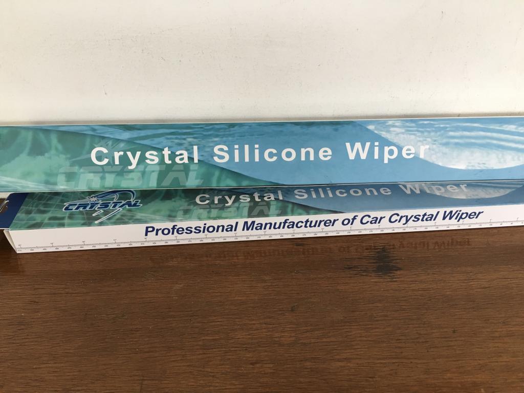

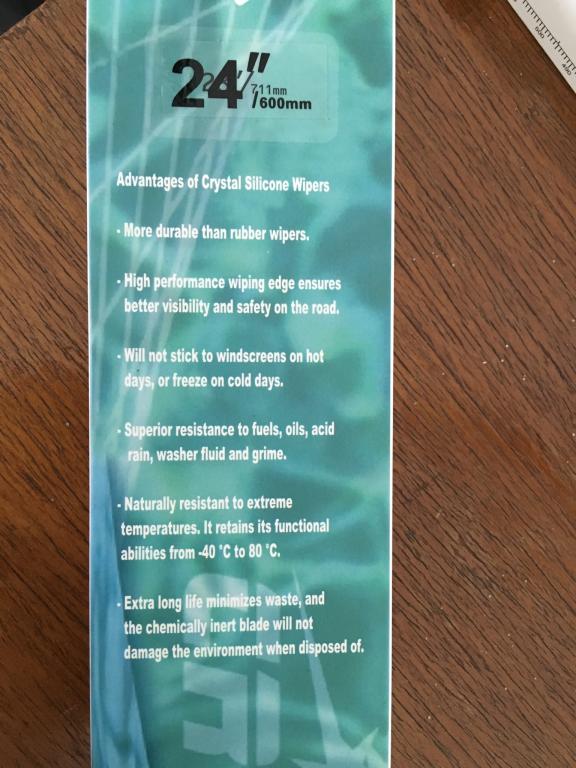

Friends, I have found an alternative that works & costs a lot less. No more juddering! Been looking for silicone wipers like PIAA for my CLA45 like forever & I finally found an alternative. Introducing.....Crystal Silicone wipers. Don't know where it's made but as long as it's silicone & works well, who cares. Only $75.
Got it from E-Rev Motor Sports LLP in Admiralty.
These wipers come with many kinds of adaptor that will fit various Merc models.

I went down all the way to e-rev
the salesgirl say have but cannot find, the boss came out and see and say don't have.
