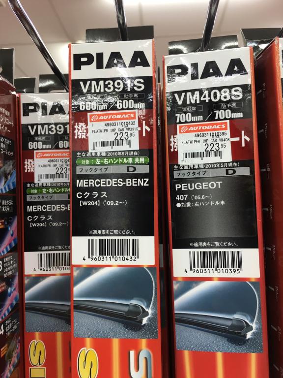

Anyone changed to a PIAA silicone wiper yet? Maybe can share the result?

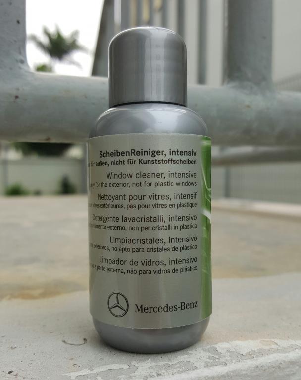

I just use the item in picture once and no such problems for past 6 mths. When FOC item is there, why not use it first.
Go read overseas forum also same issue, some X, Y or Z brand wiper works for some, it also dont work for others.
Was using these wipers when I had the W204. Very good but expensive. Was priced at $159 previously in Autobacs. Today I saw them retailing at $224....faint.
Can buy 3 sets of original wipers or 6 sets of OEMs.
