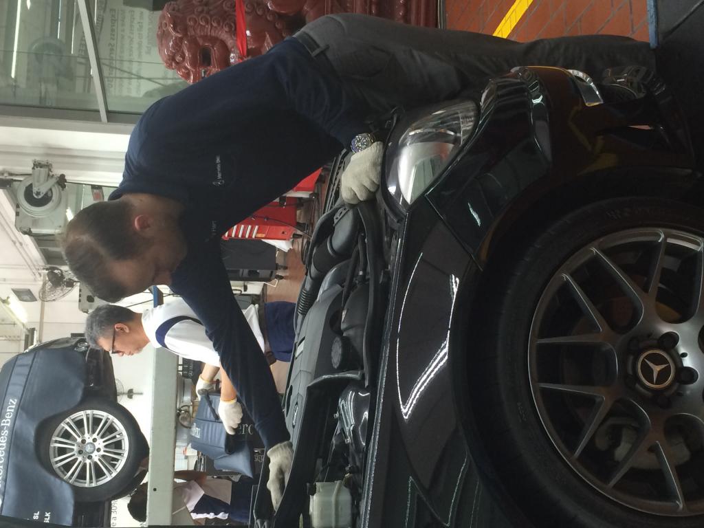

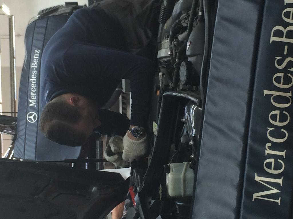

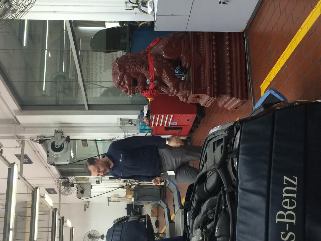

I went last year at MBC!
Not only angmo attended to my car but include the attention of CnC Tech Mgr Edison.
