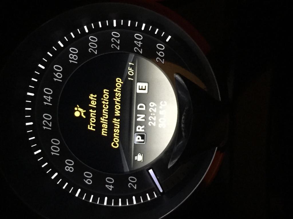

Need help .
ron5000
I experienced front right before which is the drivers side airbag. Went down to workshop, found out the connector on my steering column was faulty and had it replaced. While workshop was diagnosing, they did mention a few possibilities that'll cause the error such as lose connector, faulty airbag, faulty wiring, etc.
Best to get it checked ASAP.
