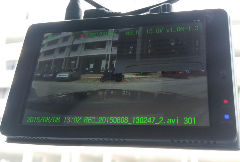

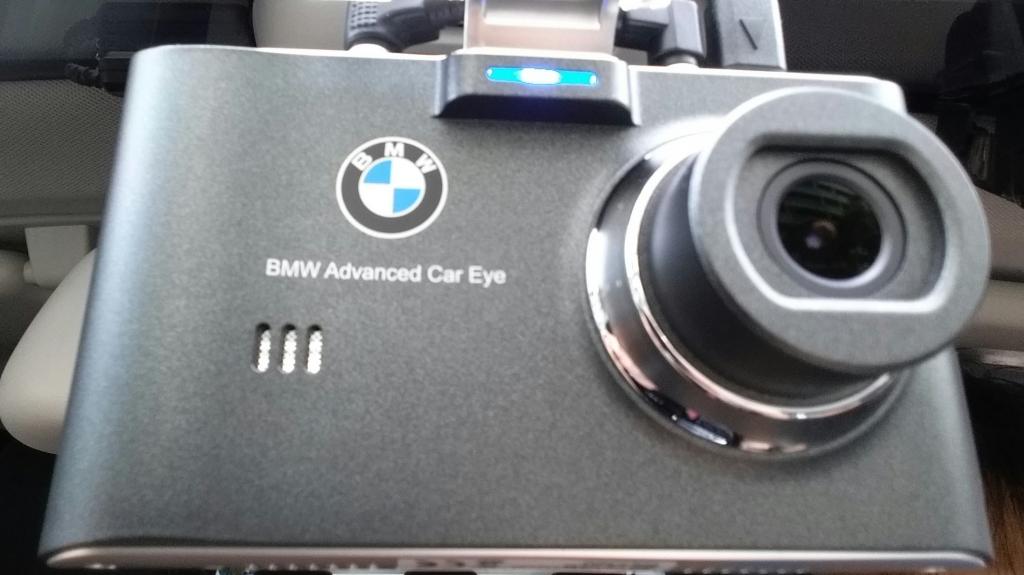

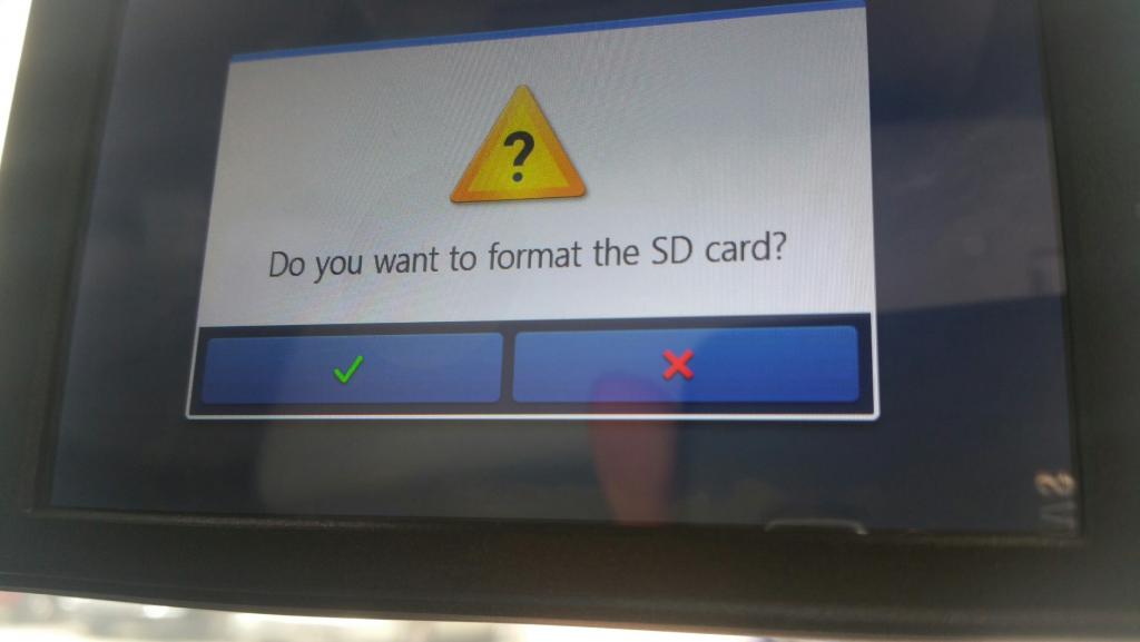

Installed BMW Advanced Eye Camera front and back...used in my previous ride and found it reliable with ease of use...i like the large TFT touchscreen LCD that allows simultaneous viewing of front and rear image..front camera is 1080HD and 760HD rear...there is a events folder that the camera automatically stores for ease of reference and playback..memory is stored in a micro SD card. Camera has park mode where it records 6hrs before shutting off to prevent battery drainage. A blue LED light on camera flashes to warn anything coming near..i particularly like the ease of formating the SD card at the touch of the screen when prompted. $680 with install at elebest.

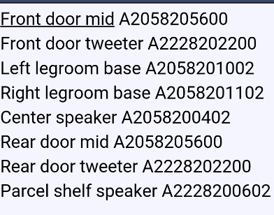

From what i read basically the burmester audio setup has 13 speakers and 1 amp plus software coding...the only special thing is that you pay for the merc and burmester manhours supposedly spent on tuning the audio system to the acoustics of the cabin to get that 3D effect. Definitely you can install..just need to fork out the 3k plus for it...you can enquire with elebest about it or bring in the system yrself.i attached the part numbers for your reference if you are keen on it.
Thanks for the info. I understand from the merc website that the standard setup has 8 speakers? So u changed all 8?
Nope i only changed the mids speakers on the 4 doors..to me sound quality is good enough and i also did it for the aesthetics...at most i will add 4 focal tweeters to fit in the dummy empty tweeter housings..found a modder who did this in his W205 as focal tweeters can do a better job than the burmester...
installing dashcam will void warranty?
If you never wire the camera AC supply to car fuse box and wire the camera internally through the rear view mirror housing then will not void but if you do any or both of the above...yes they will void if they want to be anal about it..they will void warranty fr your rear view mirror and fuse box electronics if they want to...you can just install and wire the camera to the cig lighter if you worried but is unsightly as messy wires exposed and dangling

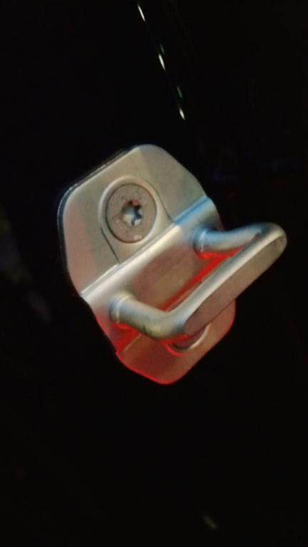

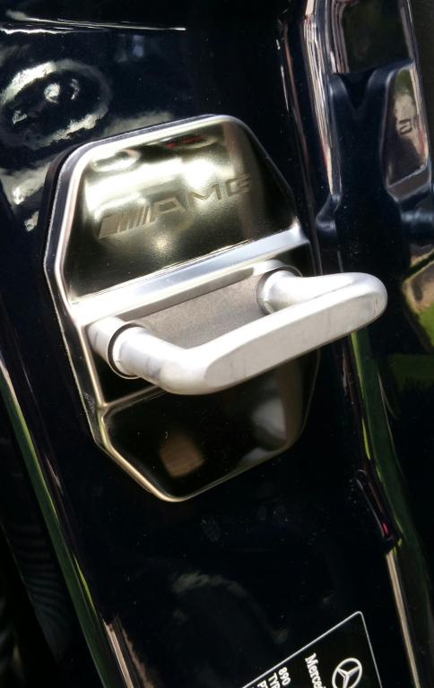

What are the Chinese words to search for those amg covers?
I like your mods BTW
Tks bro..look for door catch cover, 门扣盖
Alternatively you can msg forummer by the name of
Slowpoke....he may have a extra set of these which he ordered last time n he is selling
