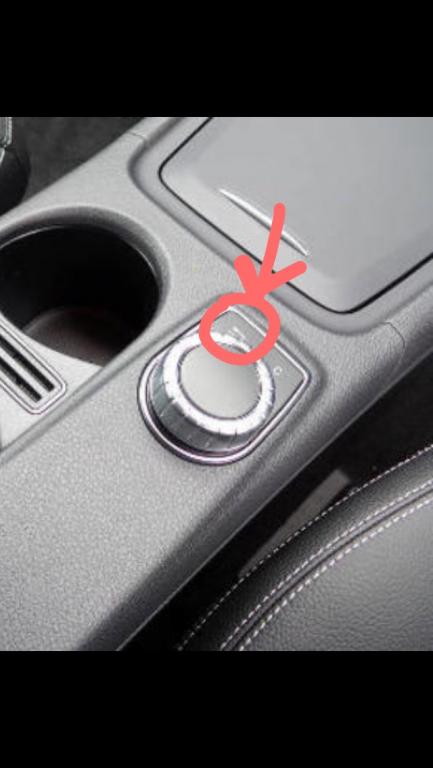

works for CLA.
when in reserve mode press and hold the back or c button near the jog dial to activate the settings mode.
you can set the parking guidelines to on.
do note that it is static lines and not the active dynamic parking guidelines.
works for CLA.

My bad, just realised I had to press the 'C' button next to the Command dial and not the back button on the steering wheel control.
Managed to activate the static lines, which I'm quite used to from my previous rides.
Thanks Darksaint!
Thanks Darksaint!

Hi hi, meaning the static lines is available on the locally fitted camera for the a class. I tried pressing and holding on the clear button next to the command dial when in reverse mode but could not access activation menu.
Yes it's possible.
But press the 'Back' button not the 'C' button, which was my initial mistake as well.
Be careful on what you click in the menu. You could end up disabling the entire reverse camera system, which has happened to our members before. Only way to resolve is to replace the system.
I tried on mine. it worked.
I pressed the "c" button. After a while, a menu will pop up on the screen and you can change the settings. But it's quite a technical menu.

I tried on A180 (collected Oct 2015) which came with Audio 6 system, none of the button works when in reverse.
Would you mind to share the steps?
Yeah, sure. But I'm in BKK now, so I can only share the steps when I get back.
I remember I had to hold the "c" button for quite a while before the menu came up.
