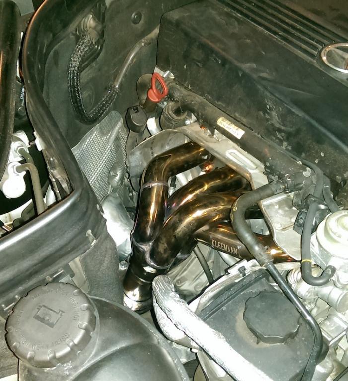

Kleemann header just installed

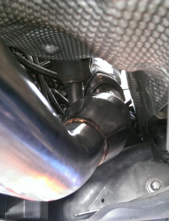

Kleemann down pipe with catalytic converter viewed from under the car

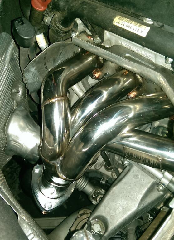

Header turn golden (used).. LOL…
