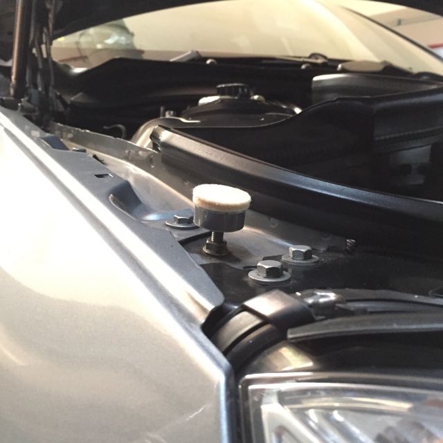

Not sure whether your problem is similar to mine. I spent $2+K on the shocks and lower arm links to find the problem still persist, though there was improvement.
Finally I got rid of the sound totally by lowering (adjust) the hood stopper, plus put a felt over it. It was a DIY and $5 job.
What caused the sound was the hood stopper rubbing against the hood whenever the car went over humps. You can check for marks where the stopper comes in contact with the hood.
See photo of hood stopper:
To add: Adjust both sides and ensure they same hight. Apply felt on both. Let me know if this works for you :).
